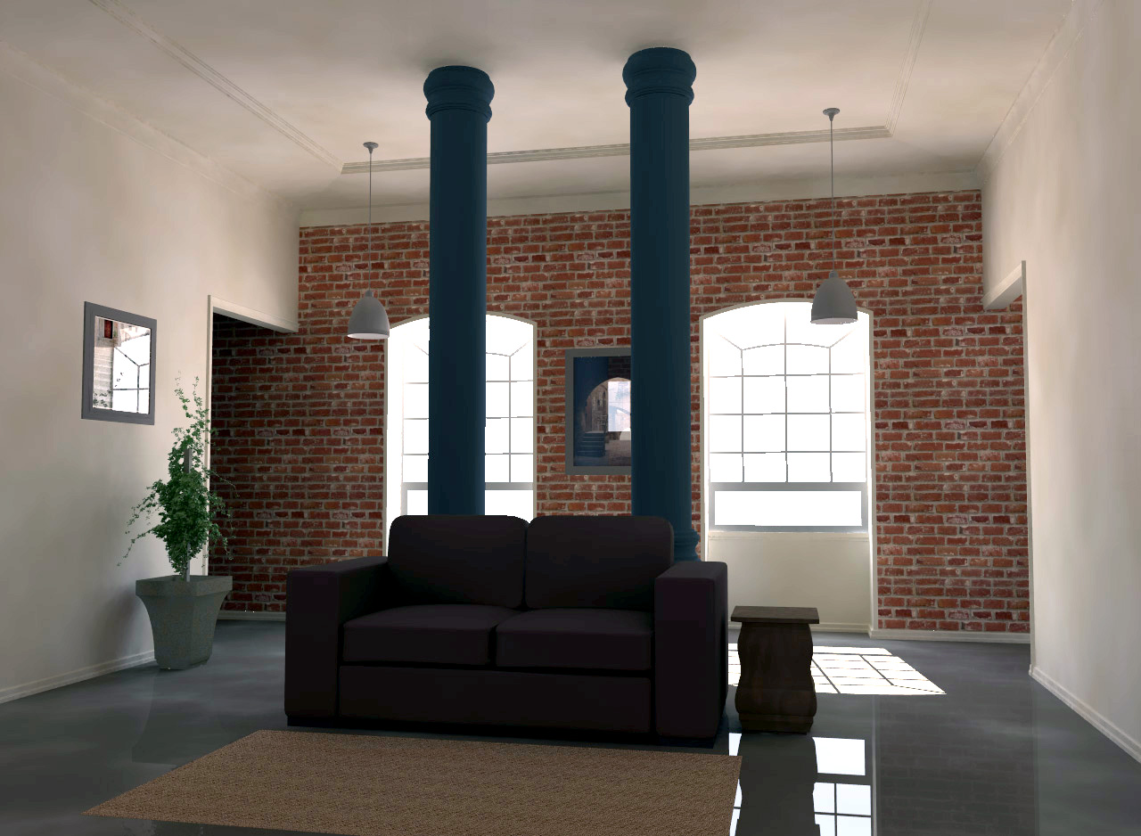

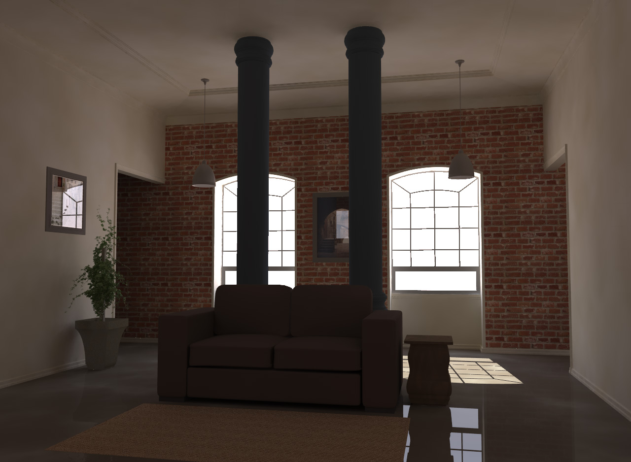

ARRUUUUUUUUUUUUUUUUUUUUGGGGGGGGGGHHHHHHHHH Why do I suck so bad at lighting! </rant>
Okay, sorry about that. I just don't get it, I fully admit I don't understand CG lighting. It's the reason why I purchased Kray a couple of weeks ago, to help me learn, but I'm getting frustrated again. I know there is no quick fix, & I'm not looking for one, I really want to learn Kray...I've seen what it can do by many of you on the boards. I just feel at a lost as to where to go. Many of you have been very helpful, and I appreciate the tutorial that Jure had created. But it seems when I try to apply even the same settings in Jure's tutorial (i.e. basically trade out rooms) mine is still so dark. Granted his room has larger windows, but the windows I'm working with are decent size for the room.
I even tried it with a scene from a thread on the NT forum, where again...basically swapped out objects/rooms, used the same settings & everything, and used my room I created (the one I posted on this forum for people to play around with, practice, & learn from one another - found here). What I don't get, is when I did that, I would have thought, I would have got relatively the same illumination in the room...but no. It was still so extremely dark, and I don't know what I'm doing wrong. Any help would be VERY much appreciated.
EDIT: P.s. I've attached an reference image/render. This is what I'm not getting, it would seem like from the light that is on the floor, that there is a decent amount of lighting coming in. Why is it that not much else of the room is very bright?

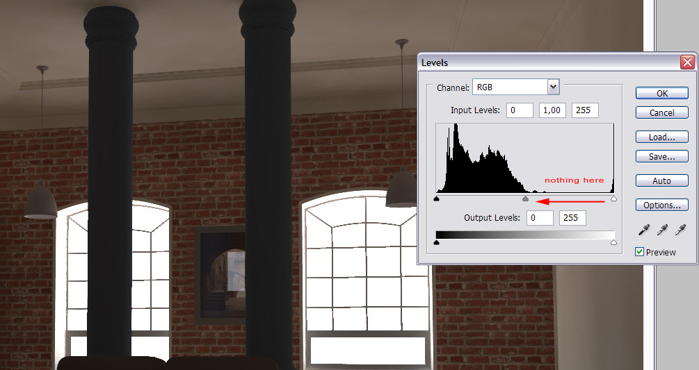

Ok, here's one idea about "what you're doing wrong"... You have Photoshop in your hands? Basic idea of photography as well as CG, is to check your levels in image. I got your image to PS and saw there was practically NOTHING in some points of levels, so I "deleted" them...
Here's attachment of the photoshopped image you sent, even though the GI solution is bit splotchy, you'll see the difference? Also tweaked the colouring little by adjusting the ratios of yellows and blues...
Also a shot from PS, to see what I mean.
You cant always get the results you want by Kray, or any other renderer, that's where PS comes at hand... You can create quick results with Kray that look good, if you just PS them a little...

Learning from other scenes is a good starting point, but even Kray settings ought to be fine-tuned to your own scene.
Lighting too you can learn from other scenes, but here's a tip. It might sound sarcastic or obvious, but here's the thing; to brighten a scene, add more light. Make your environment brighter (use values like 300% for the layer opacity of an additive layer in Textured Environment) as well as your sunlight's intensity. Alternately, use Kray's exposure value; it just multiplies the values in your scene, making the whole thing brighter.
Also, make sure you're using a good amount of Gamma tone mapping (1.8-2.2 depending on your computer) or Exponential (around 3.5-4), or rendering to HDR and toning it in Photoshop or another HDR-capable image editor.

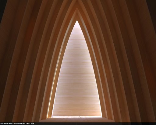

This raises an interesting question for me. How much have some of the fantastic images we see on the forum been post-processed with Photoshop?
We have all seen some brilliant stuff where people have indicated that no pp has been used, and others where people have posted exactly what they have done to the images. The point then is how hard do you need to try to get lighting right in Kray if you are just going to correct results in PS afterwards?
I really don't know the answer to this, and try to get the best results possible from a 'raw' render. My attached images show this. Some time ago I did a quick, but demanding test with a single area light sun to see how well the GI worked. It is a simplified model of St Henry's Ecumenical Chapel in Turku Finland. There is only a small opening at one end of the scene, and I tried to duplicate the lighting effects quickly. Virtually all the interior lighting is indirect light bounced around, so it's quite tricky. I didn't want to cheat by adding additional fill lighting because I wanted to see how close Kray could get using physically accurate principles.
The raw image isn't really good enough, and I didn't really know where to start to improve it! So out of curiosity I just applied Irfanview's 'auto-correction' feature. I think the resulting image looks a lot better, and for the sake of 5 seconds in Irfanview, I saved possibly hours of rerendering and tweaking lighting and render parameters. Ultimately the final result might still not be as good as the auto-levels correction. I accept that it isn't a finished image, but it was a really interesting exercise for me.
Also if anyone can post any hints on how to approach lighting for this type of scene, I would be interested to hear about your approaches.

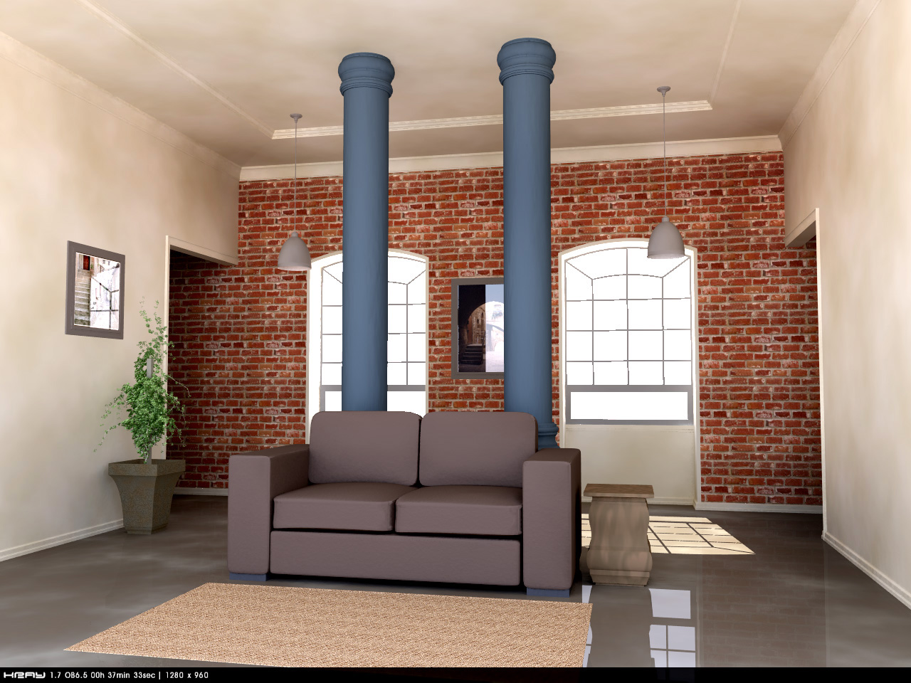

Okay, here is a re-render. Textures still need some work, but tell me what you think. This was kind of a cheap trick, I basically just took off the wall closest to the camera and toned down the light so as not to completely blow out the room. Then a little contrast added in PS. This is a little more of what I'm looking for, I've just gotta see if I can get it with some of the suggestions mentioned.
