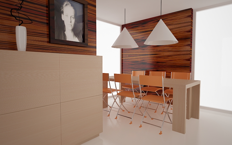

kitchen
Post by sustin »
kitchen
14min
14min

I'm not seeing much shadows there? Love the mood and so on, but I would like to see heavier contact shadows (for chairs etc), because the light seems to come strongly from behind all those elements...

I had exactly the same feeling.

Are you sure you have global settings in LW right? (raytrace shadows etc turned ON)

MMmm yummy scene with photonmaps and skyportals :D Yeah i also misses contactshadows and think it might be due to low numbers of photons or way to high N-values so it looks very smooth and clean but without definition. If you make the glaspanels in the background luminous and use photonmapping i think you get improvements.

can you try to render this with cached irradiance unchecked and FG min 200 max 0? Then we can see how contact shadows should look like with perfect FG interpolation. Don't use too high N or precache blurring or FG blur too.
