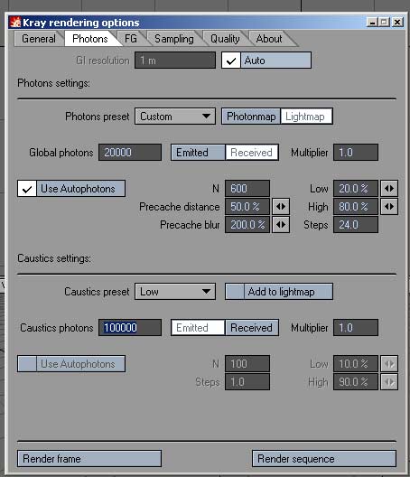

artzgodka
Posts: 68
Location: Poland
Post by artzgodka »
What photon settings did you use?[/quote]
My Photon Settings
AZ
Posts: 453
Post by silverlw »
Just a theory: You might have thought it helped since you used very low numbers of photons and since they are shoot random from time to time, you got lucky after you turned on occlusion and rerendered the leak was gone. Precache blur might also increase problems with more leaks in corners so i usually use max 100 or turn it off. If you use 200% blur and only 50% Paths i suspect there will be gaps inbetween. Check with show FG samples so you see exactly how far distance Kray will do it's pathtracing.
weepul
Posts: 24
Joined: Mon Jan 28, 2008 6:23 am
Post by weepul »
Silverlw wrote:Just a theory: You might have thought it helped since you used very low numbers of photons and since they are shoot random from time to time, you got lucky after you turned on occlusion and rerendered the leak was gone. Precache blur might also increase problems with more leaks in corners so i usually use max 100 or turn it off. If you use 200% blur and only 50% Paths i suspect there will be gaps inbetween. Check with show FG samples so you see exactly how far distance Kray will do it's pathtracing.
In my scene I used 1,000,000 photons and 0% blurring. However, right now I can't reproduce the problem, which is really strange because previously it was happening in every render.
G5 Quad 2.5GHz, 2.5 GB RAM, GeForce 7800GT, Mac OS X 10.4.11
