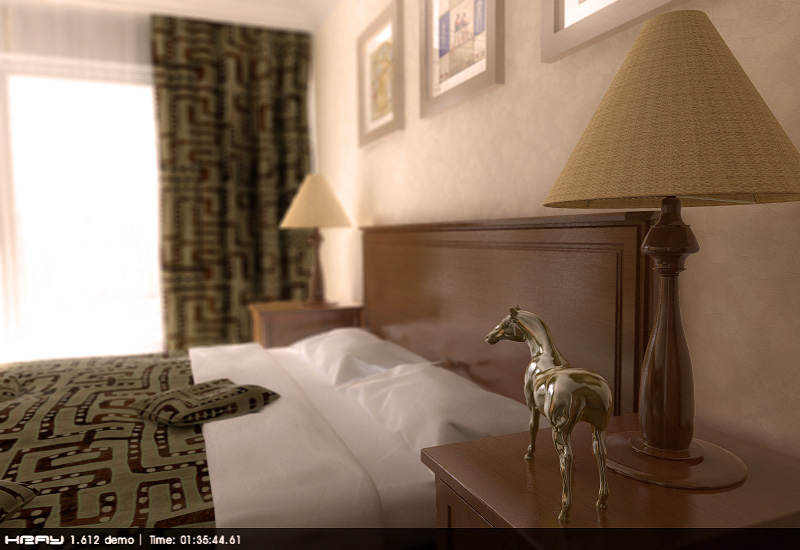

This is my work in progress (first camera). I have problem with REFLECTION BLURRING (what best speed setup for Kray - REFLECTION BLURRING?) Postprocess - Photoshop.
As usual, nice work! I like the bloom.
Regarding blure - by all means use blurring accuracy limit. I just set it at 1% and it works fine. You can also try disabeling FG reflections in FG tab.
jure wrote:As usual, nice work! I like the bloom.
O thanks!!

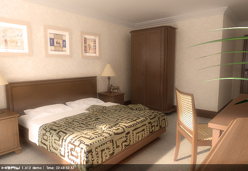

Update my work. Litle cut camera.
30 min rendering....
Awsome! I love your materials... So realistic. Care to share the secret? ;)

I must fix many bug. Many looks from camera.

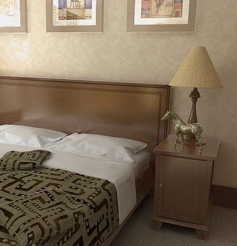

Excellent texturing, modelling, lighting and everything dude! Love the reflections on the woodwork. Do you perhaps mind sharing the Lightwave reflections settings for the material used on the head board as well as reflection settings for Kray?

Josamoto wrote:Excellent texturing, modelling, lighting and everything dude! Love the reflections on the woodwork. Do you perhaps mind sharing the Lightwave reflections settings for the material used on the head board as well as reflection settings for Kray?
O yes no problem.
Next camera and surface for objects and Kray setup.
DoF make on Z-BUFFER in LW and processing on Photoshop (he he 5 sec. DoF)

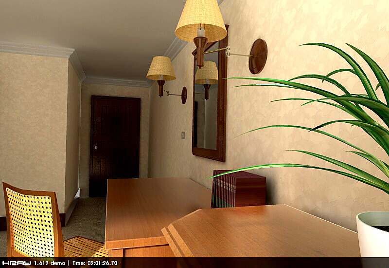

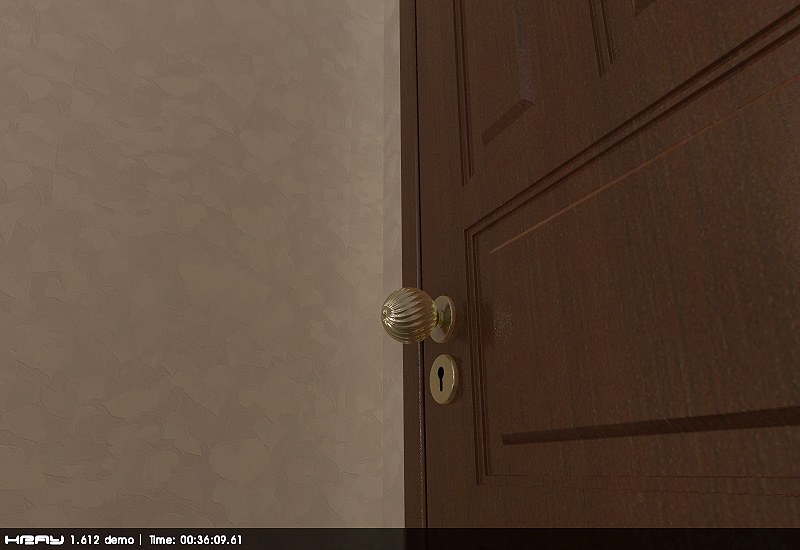

I fix this artefact (door light) I switch "on" Phat Tracing in Photon Tab.

Thank you very much johny!
I checked your settings and I don't know if this will be any better but you can try this settings instead:
FG threshold 0.0 | min 100 | max 2000
spatial tolerance: 0.1 | angle: 80°
distance min: 50% | max 5000%
B/D: 0% | oversample: 100%
jure wrote:I checked your settings and I don't know if this will be any better but you can try this settings instead:
OK testet this to night. THANKS!
but angle: 80° make low quality shadow?
I don't think angle 80° will make low quality shadows. It will make samples on curved surfaces farther appart.
I'm not 100% sure though...
