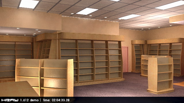

I'm new to Kray, so your patience is appreciated. Not sure if I should post my pic here or in the gallery, but here goes, coz I'm sort of asking for help as well.
The scene contains one area light near the centre of the room. About 9 other ambient point lights are also present with 2 area lights outside the shop simulating light coming from the city mall.
The render at a resolution of 630x360 too over 2 hours. I used the basic default Kray settings, Lightmap with 20000 rays. 800Fg rays and 3x3 grid anti-aliasing.
Is there any way I can speed up the render time without losing too much quality!
The light splotches between the back ceiling and wall are due to gaps in the geometry. That's been fixed and currently rendering.
Your help is much appreciated!
I also touched up the image in PS CS2 a bit. It was too dark and I cooled the colours down a bit as the scene seemed too red overall.

...and here is the result.

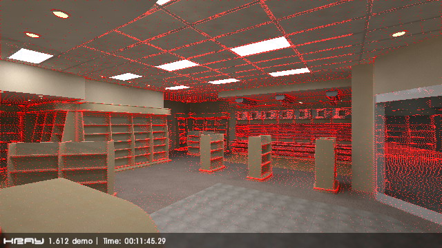

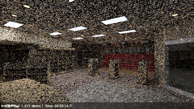

- Photons Estimated, Global Unfiltered
- KrayOpt01.jpg (155.17 KiB) Viewed 7301 times

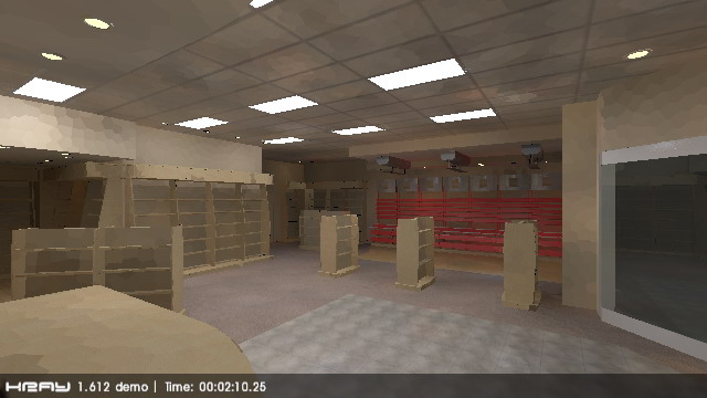

- Photons Estimated - Precomputed
- KrayOpt02.jpg (49.27 KiB) Viewed 7276 times

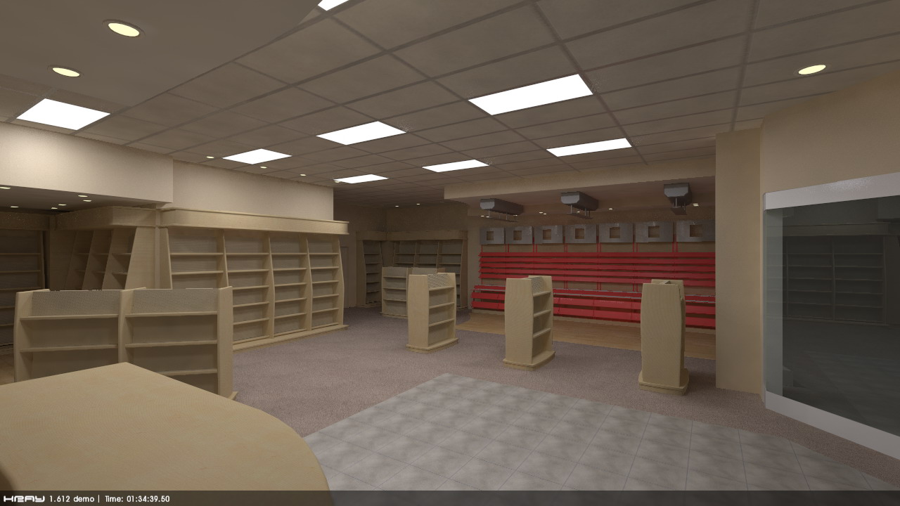

- FG Strong
- KrayOpt03.jpg (102.42 KiB) Viewed 7265 times
- Final result with AA
- KrayOpt04.jpg (139.77 KiB) Viewed 7358 times
Looking good!
There seems to be enough photons in the room and irradiance is quite good also. Maybe you'd want to turn up the N value to smooth it out even more.
The FG settings can be improved though. I would turn up the oversample to 100%. This has been changed in 1.6 so the settings from the tutorial don't apply anymore. Before lower values than 100% improved FG but with 1.6 values over 100% produce denser FG.
You can try lower spatial tolearnce settings also, which will give you more details in shadows. You will probably need to turn up max rays though...
Also try Grid Ful screen AA, grid size 3. Turn Undersample to 16 or 32 and threshold to 0.0. This will make Kray render AA in one pass.

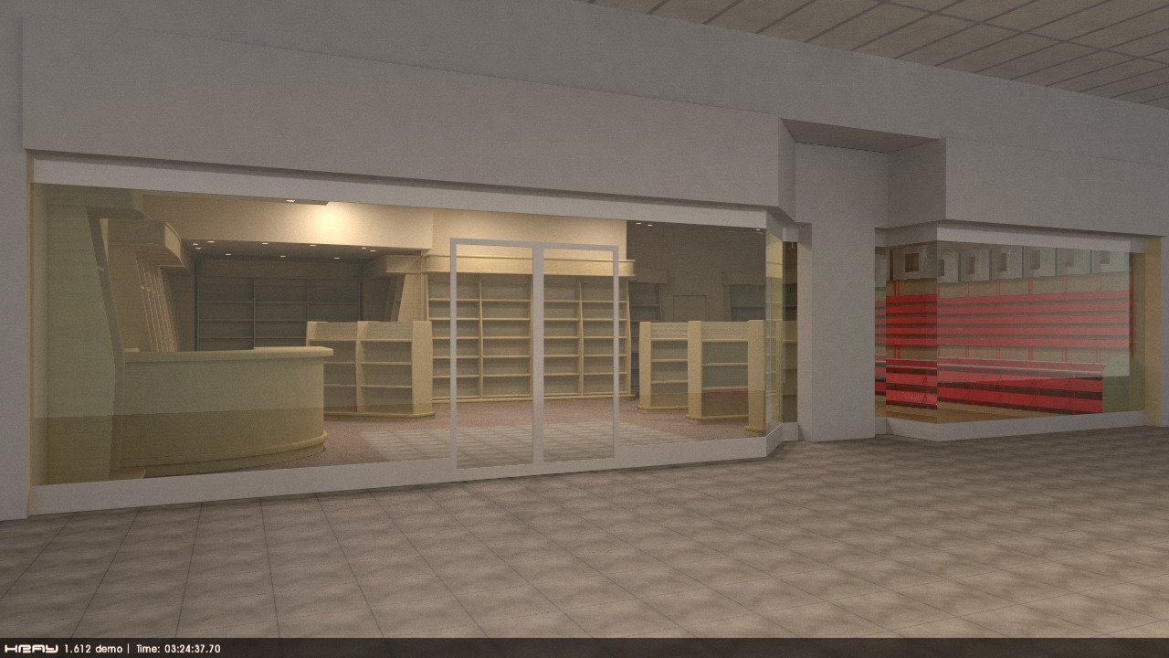

Here is a render I did from the exterior of the book shop.

- Exterior render, settings slightly tweaked, note better render time!!!
- KrayOpt05.jpg (177.26 KiB) Viewed 7362 times
