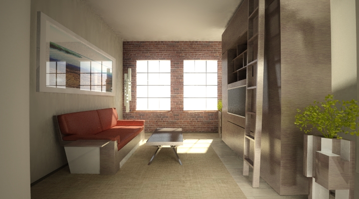

I've been using Kray for a while so am aware of its basic operations... but for this scene I can't get the GI to become smooth no matter what.
It's a very dark scene that I pull out of darkness by saving to an HDR and then re-exposing. I always get these filthy walls.
I've tried high photon numbers with N values from 500 to 3000, FG rays from 300 to 2000, small prerendering percentage, big one, and so on...
can't get it solved.
Any hints?
Any hints?

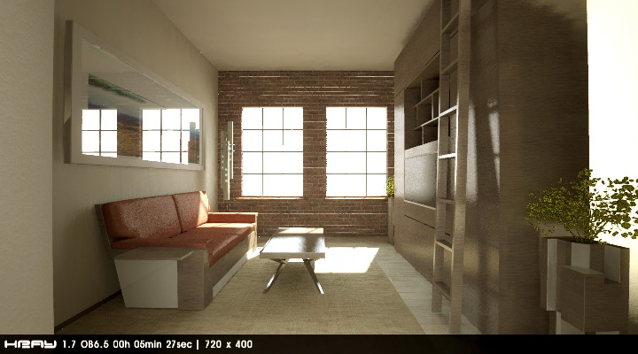

Well, I can't solve this one.
I've tried everything I can think of. 50 test renders later I've changed the whole scene, put area lights in the windows, brightened the lights changed the surfaces tweaked all of Kray's settings, but it doesn't help one bit, except that it just doesn't look atmospheric anymore.
I've uploaded the scene here... www.except.nl/overig/uploads/Condo.zip
If anyone want to give this one a shot, please do. It's a copyrighted scene that's not supposed to leave the office, but I really have no clue how to tackle this.

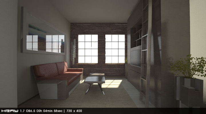

Okay,
I removed the extra area light
Turned off the GL light (not sure if it mattered)
Removed luminosity from everything
Removed the kraypanel from the walls (left it on the plant)
Set tone mapping to gamma with 2.2 / 2.2
Picked the medium preset
Tweaked the AA settings (grid 2 and .2 on detection)
and did a render on my "not that fast" laptop.
The result is this
(Now, it doesn't look very good, the AA is pretty bad and the settings could use a boost in general, but I think the GI looks clean enough.)

That looks okay although its a bit hard to see... It's a lot darker than mine. Once you brighten it up the noise really starts to show.
The luminosity is only on stuff that actually glows (LED's etc)...
That area light is gone for me too...
Removing Kraysurface from the wall doesn't help
Tone mapping is only relevant if you render to non-hdr (which I don't)
And the AA is okay...
Boo, I don't understand

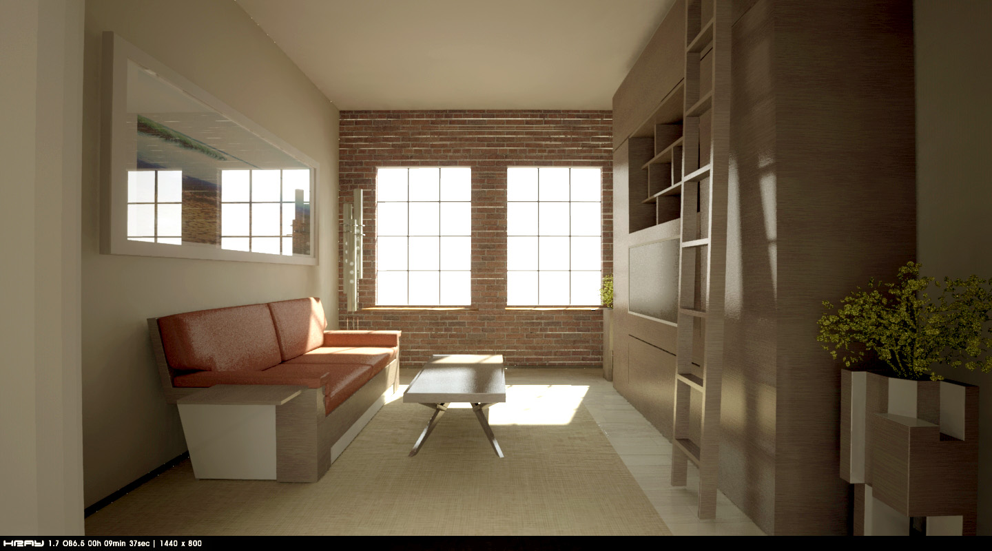

I think I'm already seeing some blech between the couch and the painting...
You know what, there's a bumpmap on that wall.
Removing it makes it better (although not fantastic).
Edit:
Cleaning up the model helped a lot for me too, not so much with the noise but with weird lighting. The stairs were starting to emit light at some point and random areas would just be very bright all of a sudden. Most of these models are converted from sketchup and are not so perfect...
Edit:
Also, apart from the bump, you had a gradient by bump on color which I think is buggy with kray. Anyway I also removed the bump from the wall and did a 1440 render and I think that wall is pretty clean now.
If you use lumi lights make sure they are a different part each.
