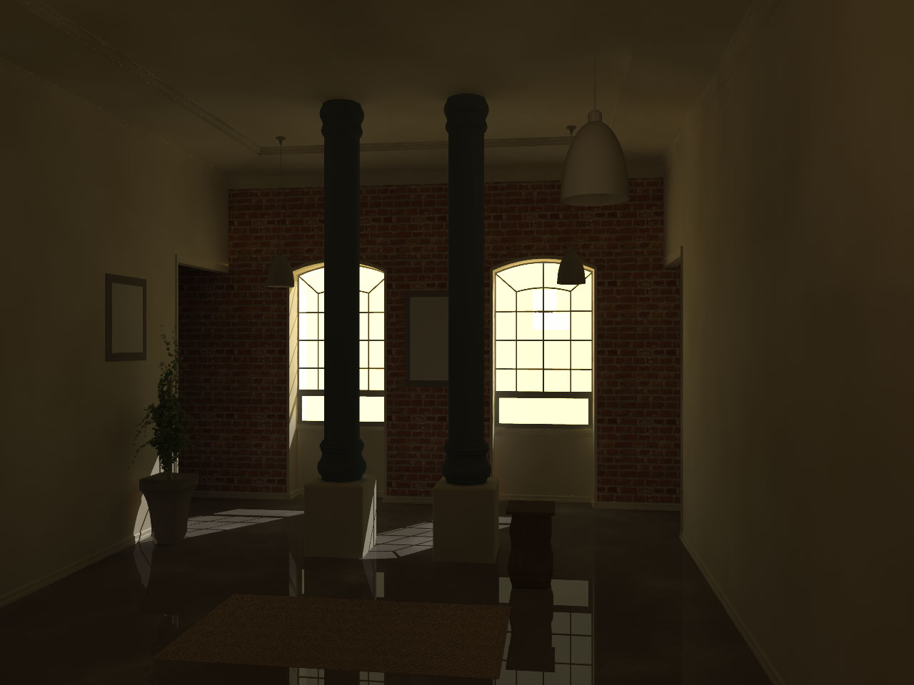

Okay, where to start? I'm not new to LW, I've been using it for about 5 yrs solid, but what I feel that I am still new to is, CG lighting. I've attached a test render from the scene I posted. And this is what I don't understand about CG lighting and could really use some help on. If you look at the test image I've attached it's very very dark. But the amount of light that is coming through the windows seems like a decent amount. Why does it seem like the rest of the room doesn't receive much of light. How do I get a properly lite room? My intial reaction would be to add some lights inside the room, but that's what I thought one of the benefits of Kray was, not having to fake GI.

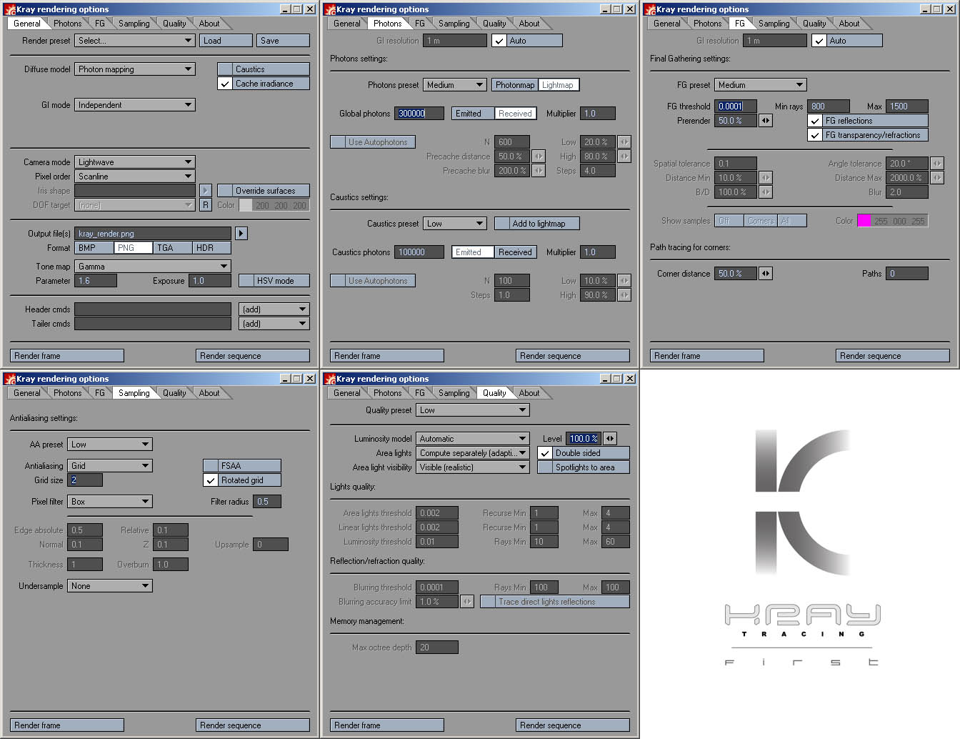

I've attached my settings (which are very standard because I don't know Kray yet) for any reference. My main light source is 150% with Inverse Distance ^ 2 at 1 km fall off, with a SunSpot settings found in Jure's tutorial.
Posts: 453
Post by silverlw »
You may increase light by changing gamma to whatever suits you or switch to exponential 10 for example. that will defenetly brighten up the room for you.

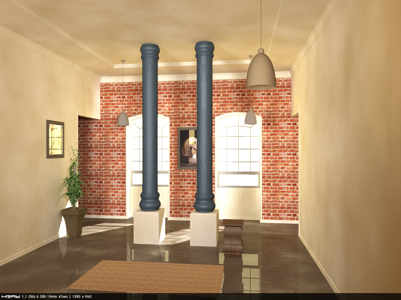

I've attached an image after adding some area lights externally, and upping the parameter to 4.0 & exposure to 1.5 on Exponential.
Is there to optimise the render speeds, I'm getting almost 19 1/2 minutes on a Quad Core processor for a 1280x960 resolution. I've seen others on here get much better times on half the horse power.

I suggest you leave area lights out as much as possible... You should get that same result using skydome around your house, adding it 400 % luminosity and then use the new krayindirect shader, multiply 2.0, maybe try with limited dr does for you...
Then add photons around 500 000, multiply 2.0 and you should get pretty good light in the scene, just with those windows...
Then in general tab, set exponential and parameter to 1.5 - 2.0 which suits best, I wouldn't use exposure that much, 1.0 should be fine...

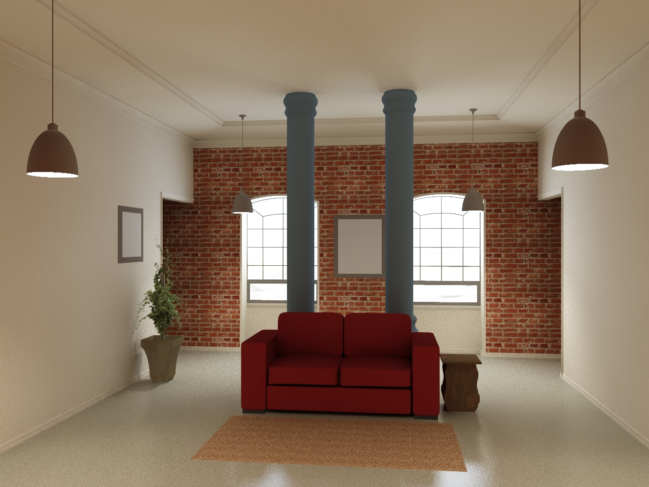

Post by silverlw »
Thanx for your scene Juggernaut.
Here is the setup the way i would do it.
I added an hdri to the window (not necessary but i like the colour from it). I have divided the 2 windows into 2 partnames (could divide it more maybe?) and i also divided the 4 lightbulbs in those spotlights.
Kray see's 6 lumelights added and renders all light under 85% as indirect (photonmapping+fg) and the light above 85% as direct (from those 6 lightsources)
I always adds Limitdr to those surfaces that casts light to further help kray a little bit. Rendertime is 15 minutes on Amd 4400+.
Wii Fit Scene.rar
