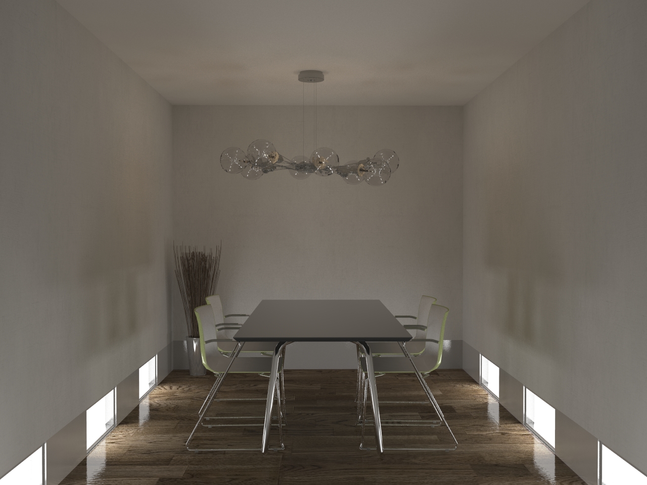

Lighttest with 6 luminous planes along the bottom line. Every luminous surface as one part and rendered with luminous threshold rays min/max =1. This is straight from Kray.

So what we're saying here is that setting each luminous surface as a separate part practically eliminates the noise usually associated with lighting from such surfaces?

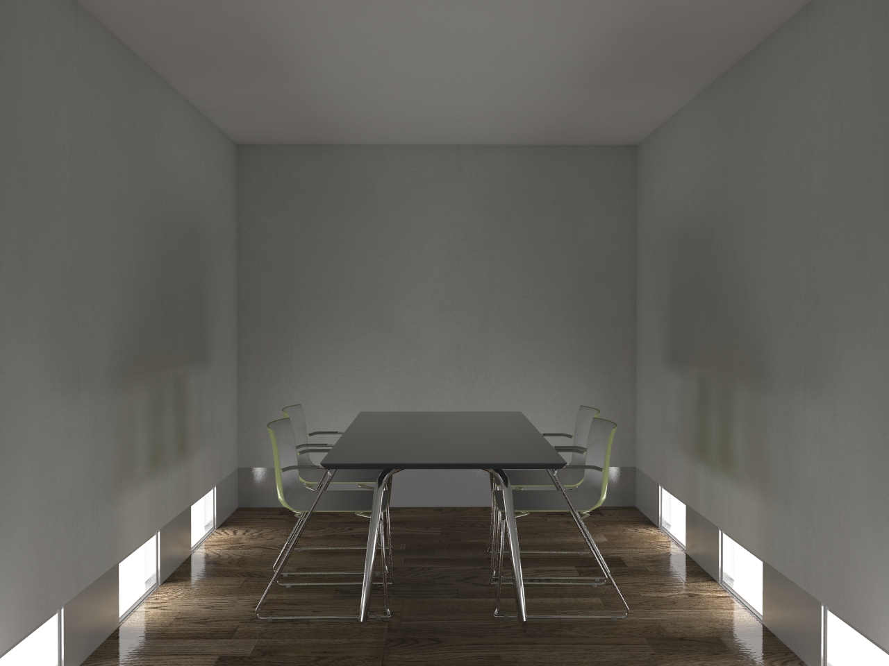

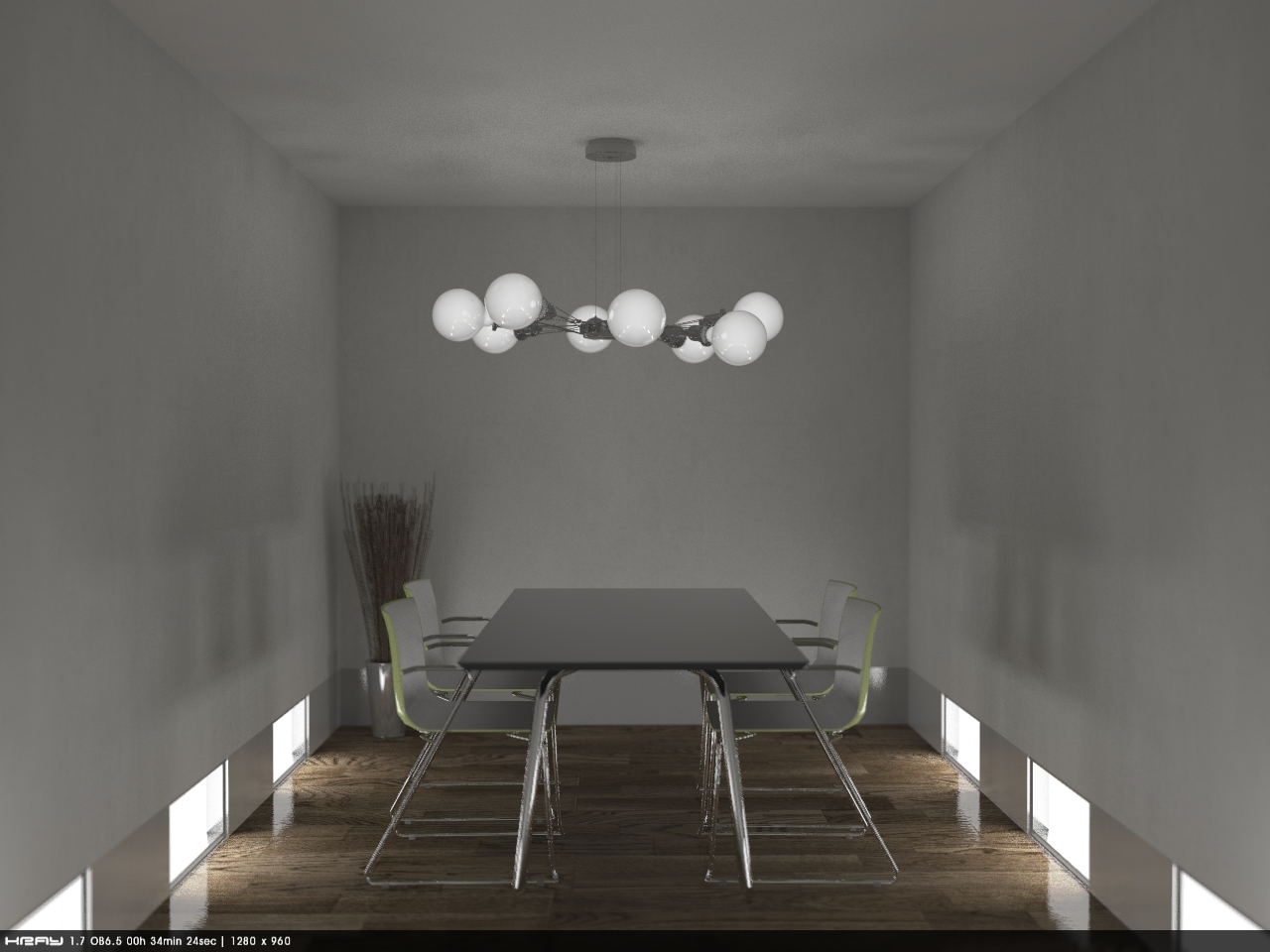

yep! Try autoparts plugin found here http://www.kraytracing.com/index.php?su ... oParts.zip
OR set the part by yourself

Question: if a luminous surface is composed of many polygons, is it better to unweld them all and declare each one a separate part, or does it not matter?
I like the surface on your lamp shades. Can I have it? :) (No, seriously, can you share it?)

Neat renders, though I would love to see more light in scene... Anyway, one thing bothers me though, is why the chairs etc don't reflect on the floor, when the lights do reflect quite a lot...
Posts: 453
Post by silverlw »
Lights have luminosity 1000%,floor only about 4% reflectivity. You dont see anything else except lights on the floor.
