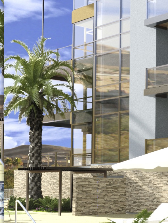

hmm it works, but any idea why the transparency is not taken into account?
is there a header for that?

I meant the reflection seems to be lost on the main windopane, (it seems to be reflecting the palm tree but not the environment)
I faked it by placing a solid layer in AFX though, looks like the transparency is OK up to 2 or 4 recursions, but if there is more glass behind it is does not compute (I need to test this, not 100% this is correct)
Also, (lastly) is it possible to have the alpha channel already included in the file itself? ( I think it gives a cleaner alpha than a separate file (or Im not sure how to do this correctly in PS)
