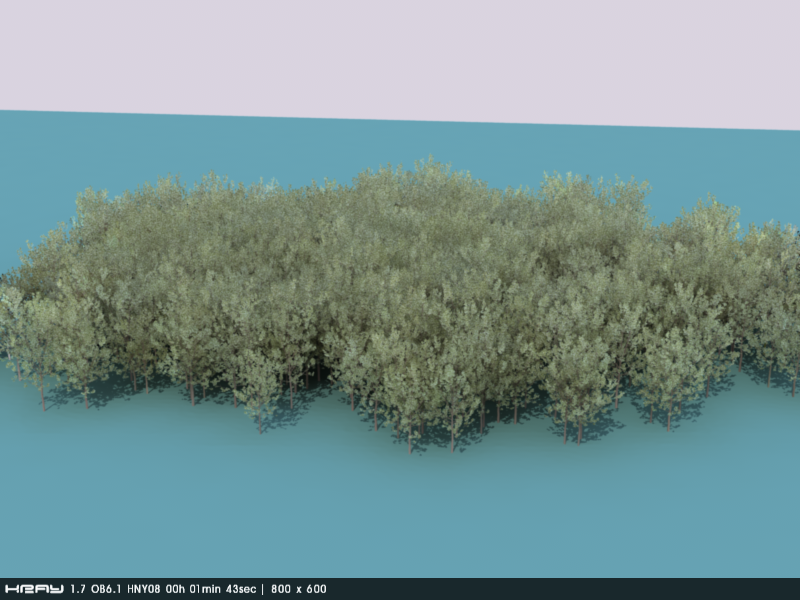

My quick and dirty test with 730 instanced trees
Post by silverlw »
Cached lightmapradiosity and adaptive grid3 AA. I turned on Photonmapfiltered only for the trees and they renders really quickly. If i can do 730 trees under 2 minutes per frame anything is possible.
