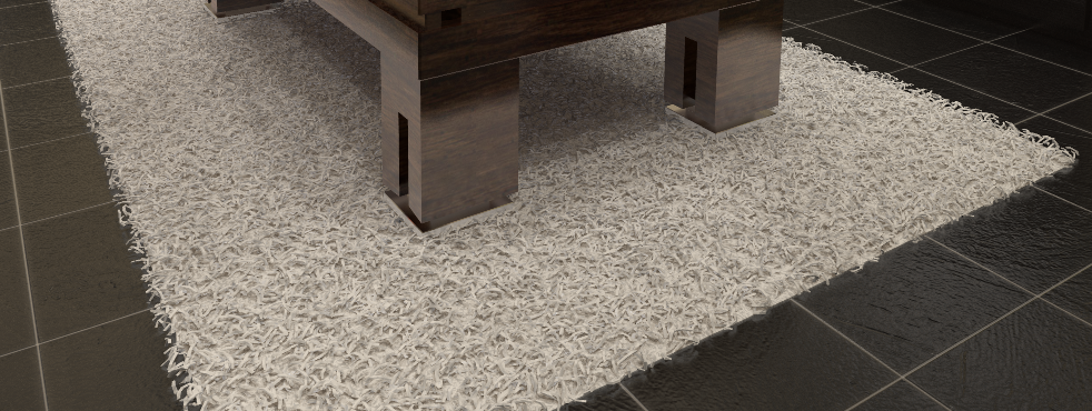

Hi everyone -
Another installment of my weekly questions here...
How would you get around creating a furry rug like this one? I tries Sas , but I realized its a post process and not "seen" by Kray.
I would need to make it with geometry, will any fiber generator render in Kray?
Any ideas? very much appreciated.
Matt -

Answering my own question here in case anyone needs something similar
I solved this using point clone as someone mentioend in the NT forums, I did 4 quadrants and used the Kray clone, so its light in geometry, that worked.
slow rendering, but trying using filtered GI on that surface thanks to the new shader panel (super handy)
