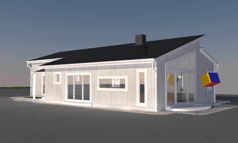

Here´s the scene I have been fighting with for a while now... I would be a lot happier if someone with more skills than me could take a look at it and see if there´s any salvation for it!

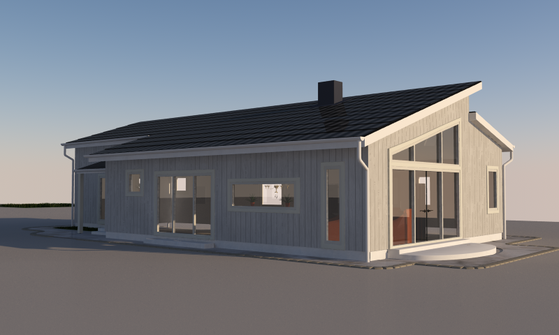

this is just a technical test of your scene, please try this LWS overthere.

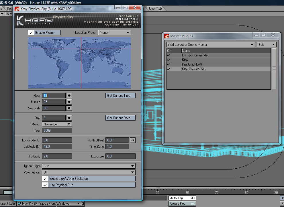

Hi Erwin!
Thanks for the tech test of the scene. I downloaded and rendered it on my PC and it took about 53 seconds. (What did it take on your machine?) I felt that the shadows and light that attached to the surfaces looked smoother and much better in your scene but since I experienced the sun´s light as too bright so I went into "Physical Sky" to see if I could make some changes there, (maybe this is the wrong place but since you set the sun´s value to "zero" I took a chance. I reduced the gamma from "2" to "1.5" just to see whats happend. Shouldn´t have done that becuase the render process was frozen and Lightwave crashed. Are Kray´s settings very sensitive in general or may this have something to do with earlier problems with the "Physical Sky" in RC5, as mentioned by Matt?

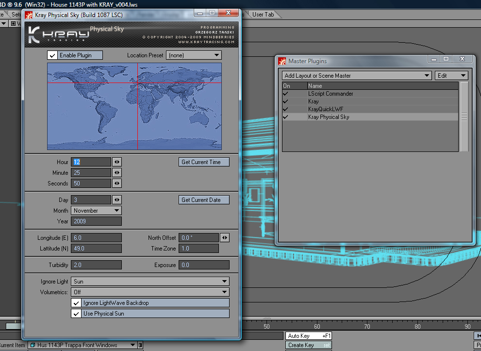

MattGorner:
Are you guys using Physical Sky on the scenes you're having issues with? I just found a nasty bug in it, it's losing any decimals on Turbidity / Exposure on save and reload. I've fixed the script and sent it back to the dev team. I wonder if there are other settings that might have this 'displayed as real numbers in the UI, loaded from scene file as Integers' bug. On noticeable when you have numbers with decimal points in them. I'm off to check!
Edit: Yep, a few others in the PhySky plugin needed sorting. The other plugins seem to be okay.
http://www.kraytracing.com/forum/viewto ... f=4&t=1735
MattGorner:

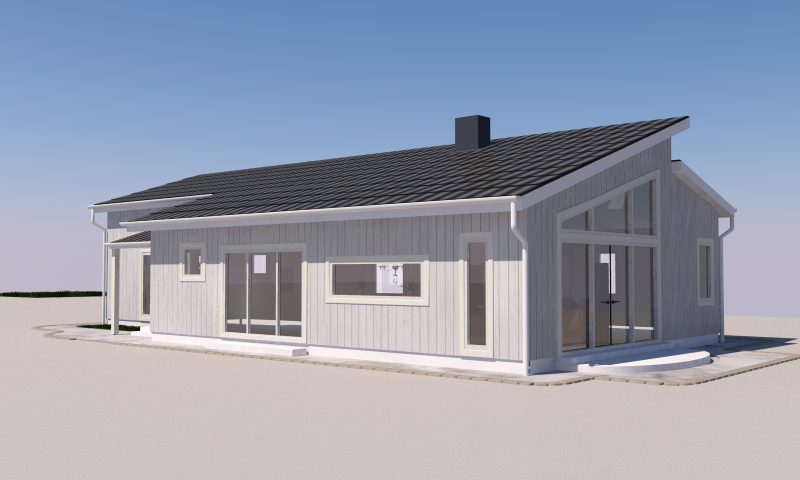

Re: KRAY is not behaving totally insane! ;)
I am uploading this scene plus objects (no Images dir) to my webspace now: http://www.xs4all.nl/~ezcc2/kray/jaxtone.zip
I saw you used luminosity and specular on surfaces, I set those to 0%.
physky does not crash here by setting turbidity from 2 to 1.5, the sky turns black though. I think this (brandnew) lscript will get some input restrictions, so use 2.0 to 8.0 for now.

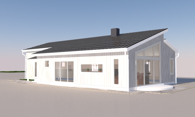

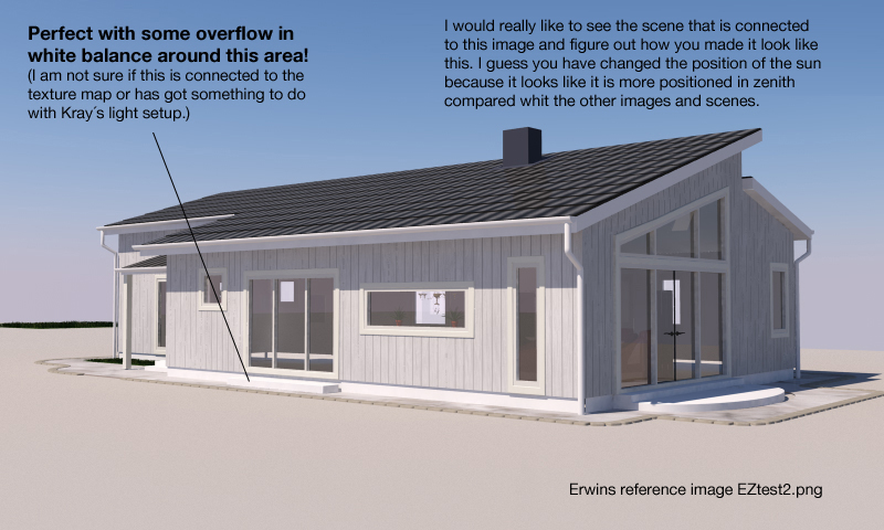

Oops! I think I did something very stupid here. Since the illumination in the scene where too bright and it still were many differences between some surfaces that supposed to be similar I thought it would help if I changed most settings for these surfaces in scene... damn this was not the best to do if the proper work schedule is to set Luminosity and Specularity to zero.
I notice that the image you´ve attached doesn´t contain any of that discusting "beige" color that I have received on the walls. I am glad to see that becuase I have tried to get rid of it by decrease the ground colors intensity since I thought that the walls were illuminated by it which is most probably the wrong way to solve this. Looking forward to see what good comes out of your efforts.
I´ll attach a test render with a totally uninteresting cube just to test the windows reflections.
Thanks!
[quote="Erwin Zwart"]I am uploading this scene plus objects (no Images dir) to my webspace now and will add link here soon. I saw you used luminosity and specular on surfaces, I set those to 0%. physky does not crash here by setting turbidity from 2 to 1.5, the sky turns black though. I think this (brandnew) lscript will get some input restrictions, so use 2.0 to 8.0 for now.
Thanks!

Re: KRAY is behaving totally insane!
Setting Turbity to 1.5 will get changed to 1.0 on reload of the scene, this is a bug in the LScript, I've fixed it and passed it back to Jure.

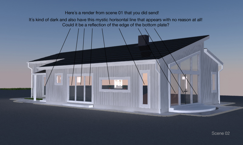

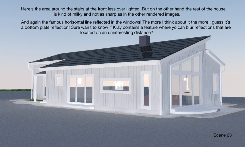

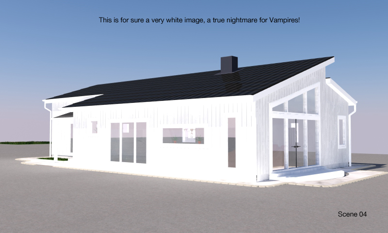

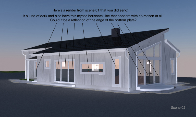

Hi Erwin!
I looked at the scenes now and I have questions of the attached image you have named as "EZtest2.png"! Please see attached image!
I rendered out one image for each scene file you attached! Please see attached images!
Erwin Zwart wrote:I am uploading this scene plus objects (no Images dir) to my webspace now: http://www.xs4all.nl/~ezcc2/kray/jaxtone.zip
I wonder one thing!
I haven´t changed the settings in "Turbidity" at all but after I save a scene and close Lightwave an open it again "Exposure" is set to "Zero"! Is this strange behavior also connected to the bug information you sent to Jure?
MattGorner wrote:Setting Turbity to 1.5 will get changed to 1.0 on reload of the scene, this is a bug in the LScript, I've fixed it and passed it back to Jure.

the final picture I showed was ofcourse the v004.lws scene. I guess you did not overwrite your own faulty objects with my corrected ones, in your render of my scene 04, your surfaces still give light.jaxtone wrote:Hi Erwin!
Also, when I load that scene back the exposure of physical sky is the same as when I saved it. If that does not happens overthere, your install must be incorrect.
I noticed in your screenshot, the Kray Tonemap Blending master plugin is gone and you have Lscript Commander in there. How did that get there?
Did you install the .lsc files of the supplied kray RC5 zip? Did you delete all old .ls files in the plugin directories that LW autoscans every time it starts?
About your question inside the picture (btw I prefer stuff typed in post to be able to quote and comment on it in my reply), I just picked a time of physical sky and I did like it. I disabled your sun, because it was placed just above the horizon. I also did delete your fake fill light. The comment of the overbright material is simple, I did not change your material settings, that is your job
Turn color down a bit. About reflections, add a nicer environment to reflect or else the glass never will look better.
Because I had to check your claim of the exposure on 0, I did load the scene, changed the time and rendered again, see attached v005 LWS and rendered result.
Forget about the older LWS's, they used your wrong surfacing and were just little tests to see what was wrong in your original scene.
Now it is time to work on your scene and worry less about kray.
