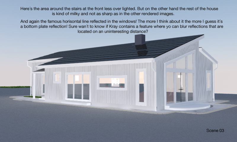

I looked at the scenes now and I have questions of the attached image you have named as "EZtest2.png"! Please see attached image!
I rendered out one image for each scene file you attached! Please see attached images!
Erwin Zwart wrote:I am uploading this scene plus objects (no Images dir) to my webspace now: http://www.xs4all.nl/~ezcc2/kray/jaxtone.zip
I saw you used luminosity and specular on surfaces, I set those to 0%.
physky does not crash here by setting turbidity from 2 to 1.5, the sky turns black though. I think this (brandnew) lscript will get some input restrictions, so use 2.0 to 8.0 for now.
The attachment EZtest2.png is no longer available

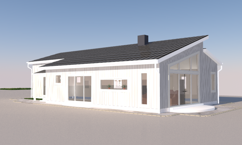

the final picture I showed was ofcourse the v004.lws scene. I guess you did not overwrite your own faulty objects with my corrected ones, in your render of my scene 04, your surfaces still give light.
Also, when I load that scene back the exposure of physical sky is the same as when I saved it. If that does not happens overthere, your install must be incorrect.
I noticed in your screenshot, the Kray Tonemap Blending master plugin is gone and you have Lscript Commander in there. How did that get there?
Did you install the .lsc files of the supplied kray RC5 zip? Did you delete all old .ls files in the plugin directories that LW autoscans every time it starts?
About your question inside the picture (btw I prefer stuff typed in post to be able to quote and comment on it in my reply), I just picked a time of physical sky and I did like it. I disabled your sun, because it was placed just above the horizon. I also did delete your fake fill light. The comment of the overbright material is simple, I did not change your material settings, that is your job ;) Your original scene looked horrible in LW and FPrime too.
Turn color down a bit. About reflections, add a nicer environment to reflect or else the glass never will look better.
Because I had to check your claim of the exposure on 0, I did load the scene, changed the time and rendered again, see attached v005 LWS and rendered result.
Forget about the older LWS's, they used your wrong surfacing and were just little tests to see what was wrong in your original scene.
Now it is time to work on your scene and worry less about kray. 8)
