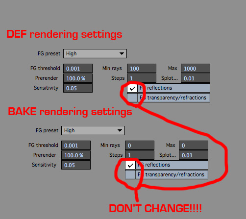

If you change the FG, be sure not to change the checkboxes for raytrace reflection/transparecy/refraction, because that wil not work for the baking. (see attachment)
Greetzzzz,
Greetzzzz,
