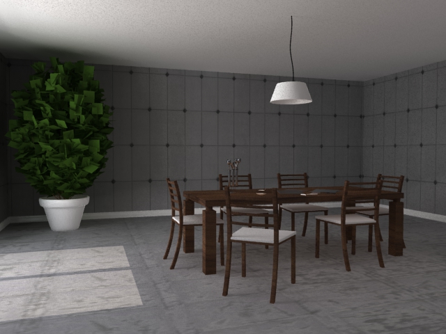

mathewlp wrote:Lumi ball 100% lumi with gradient texture, Sun beige colour with POWER 5 PHOTONS 500
Area light windows POWER 5 PHOTON 500 Inv. Dist 5m, colour light blue-white
20 bounces light recurse 20 irradianceblurgamma 0.3
Exponential 2.2, 1
spatial tolerence 0.01
Desaturate Shader on the floor 50%, 1, Diffuse 75%, reflection 15%
Power in Kray setup PHOTONS TAB 0.5
AA Hight preset
NO SPECULAR
Maybe have to increse PhotonNumberMultiplier for area
I kept this dark color for wood don't know excactly the color u wanted...
No post proc in PS
can you post the scene?
this is my render with your set...

IF YOU WANT MORE LIGHT FROM WINDOW AREA YOU SHOULD INCRESE PhotonNumberMultiplier TO 10 AND PHOTONS TO MAYBRE TRY 1000 OR MOREnico wrote:mathewlp wrote:Lumi ball 100% lumi with gradient texture, Sun beige colour with POWER 5 PHOTONS 500
Exponential 2.2, 1
AA Hight preset
NO SPECULAR
No post proc in PS

Sorry Photon POWER Multiplier to 10 and Photon NUMBER Multiplier to about 1000 or more
explaination:
You can balance direct/indirect lighting generated by light using KrayPhotonMultiplier motion modifier:
*Direct light is controlled by lights Intensity
*Falloff distance and indirect light are controlled by Photon power multiplier -->This way you can avoid over bright areas near lights while keeping room well lit.
explaination:

Re: coupe test renders
thank's for scene.

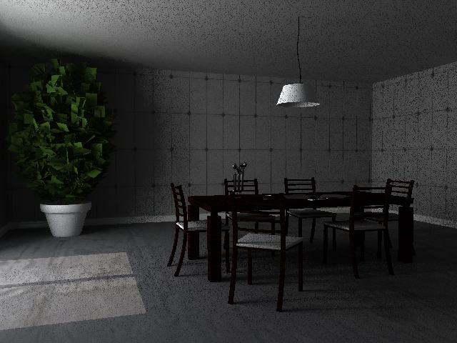

this a new render with four spotlight in ceiling...
hei mathwlp you don't think that the renders of this thread are with studio set and not with natural lighting?
Hi!talats wrote:Desaturate Shader... where is it? I can't find it in the LW Shaders
1. Apply the original, saturated texture on the floor.
2. Surface editor --> Shaders ---> Add shader ---> KrayIndirectRays
3. Set the value of "Desaturate" (Higher value means less bounced colour)
more info: http://www.kraytracing.com/wiki/Kray_pl ... irect_Rays

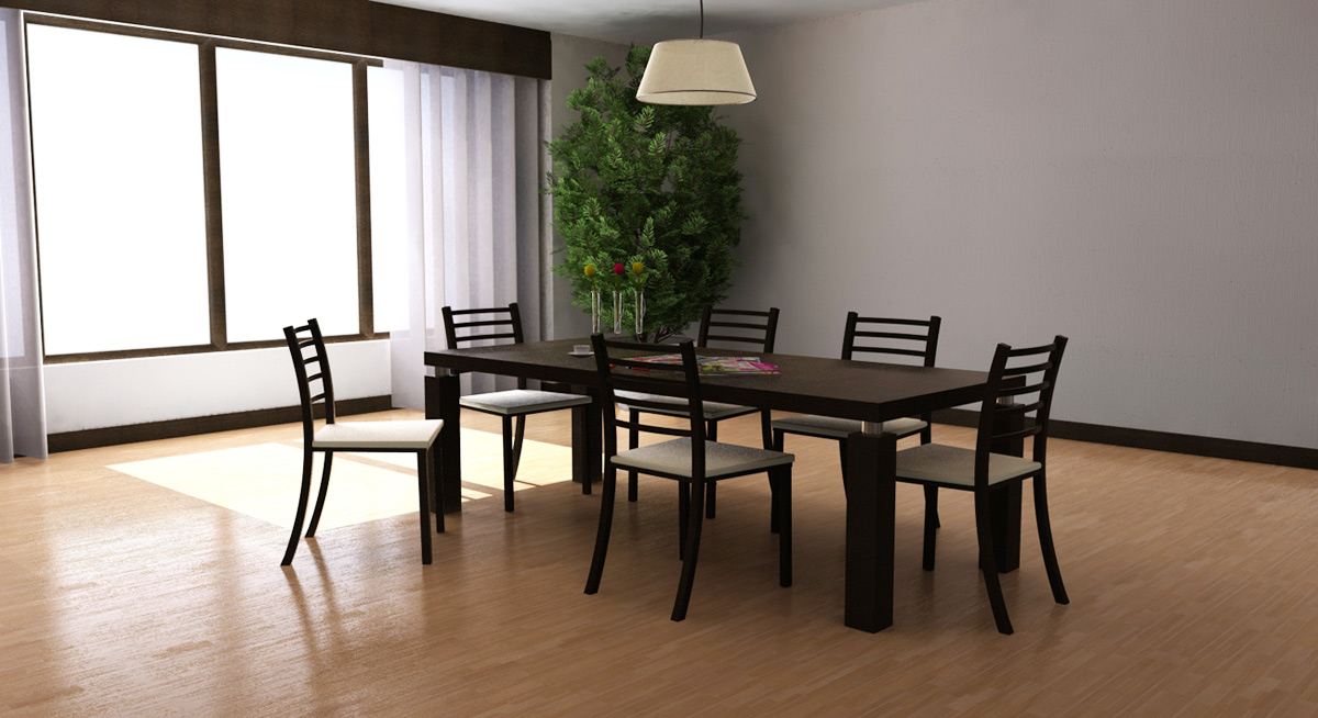

Hi, nico. Yes i tired to mimic "studio" light setup, so it has nothing to do with natural lighting. There's screenshot of this scene:nico wrote:i think you have used a backlight system in your interior but i don't understand where are it!!!
can you help me?
oh....
leftover...thank's because I was 3 days to see your image and trying to understand the setup.
but what are those objects near lights PM1 and PM6? panels are spread? are transparent to filter the light?
Just some objects to cast shadows....
