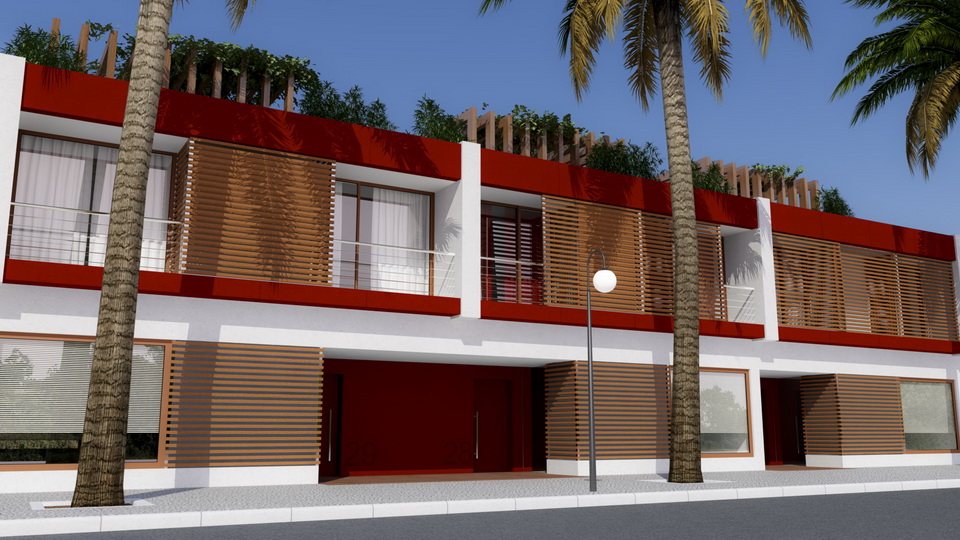

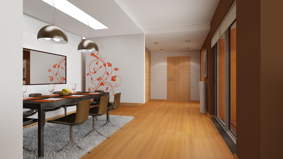

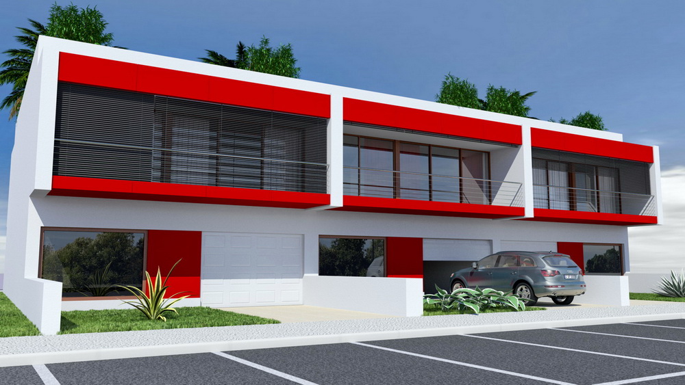

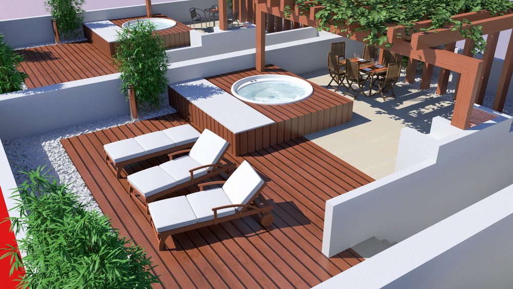

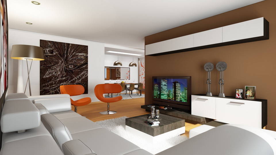

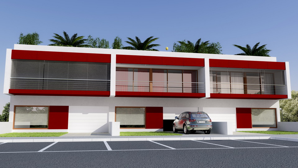

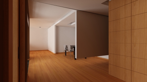

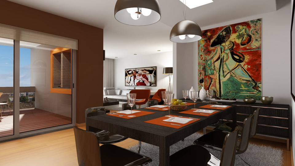

Here in this country almost everyone uses vray, my clients are always comparing the quality and my work is never good enough.
I was half way to change to vray, but with kray i decided to give one more chance, i love lightwave workflow and i´ve seen very good images in this forum.
I´ve read almost all topics and they helped a lot, but now i don´t know what to do more.
Here are some of my work, please tell me what can i do to get a litlle more reality and less "plastic" look.
Thanks

Everything is just too flat. Your light is not bouncing enough. Light must bounce, create color radiation on surfaces and shadows. Your surfaces need alot of work too. Can you send your lws file so we can check how you setup your lights and kray?

for interiors You need area lights in windows (forget about good light inside without this.... fill light from outside: sunsky, lumi, ball, SUN is not enough becouse when You increse Sun and fill light You will recive overbright windows Area)
For me the best for interiors in this point are:
1/Lumi ball with sunsky + Sun (lumi ball 100 m, 200-300% lumi, Sun beige colour with POWER 3-6)
2/Area light before windows (!) No OUTSIDE! (POWER 3-5 not much becouse we don`t have yet correction for POWER in reflection surfaces, Inv. Dist2 5m, colour sof beige or white, size ~60-70% of windows size)
3/MINIMUM 20 bounce light (this is very important) recurse 20; and: postprocess desaturate, 0.2 (for small desaturate) You have all in choice menu...
4/I prefer Exponential 2.2 (I know this a bit destroy real texture colours but make nice contrast)
5/background image MUST HAVE: uncheck all shadows and check UNSEEN BY RADIOSITY and RAYTRACING (I know after that we dont`t see reflection from background image, but we see nice blue colour from sunsky and background don`t blocked light from sunsky) Ideal is make 3D background
6/good idea....
 6/good idea....

for exterior??Johny_quick wrote:for interiors .....
roger sayd:
"I'ts quite straight forward... I have a Lightbox around the scene... sky-plugin... one Area-light with inverse distance..."

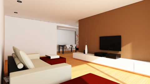

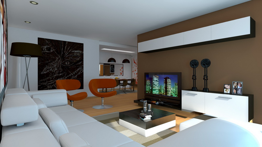

I took a look at your scene.... Here are my suggestions:
- get rid of hidden area lights on the ceiling - use lumi polygons
- turn luminosity model to indirect
- increase sun intensity
- add area lights in windows
- switch to exponential to get better contrast
- adjust qucik LWF for exponential (lower gamma)
- remove kray indirect rays shader (u need to see color bouncing)
- remove SG_CCtools (u don't need this)
- decrease diffuse on textures (max 80-90%)
this is what i get after couple of changes... Tweak it more from here to your liking....

Yes this is basic setup for exterior that works fine. Maybe you want to replace sunsky with 360°photo or HDRI though...nico wrote:for exterior??Johny_quick wrote:for interiors .....
roger sayd:

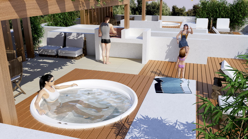

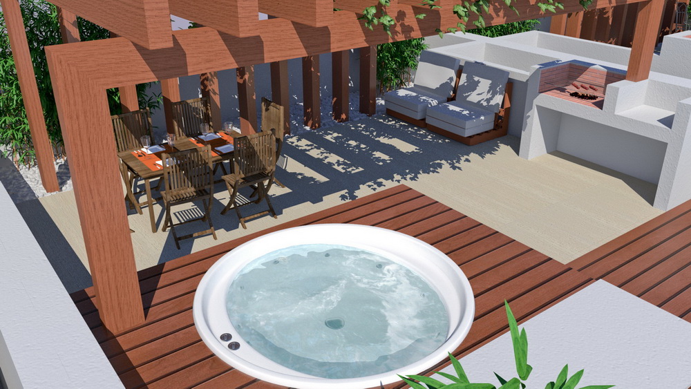

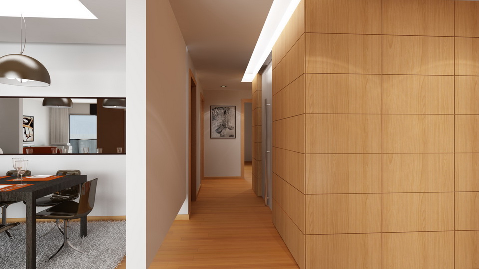

Here are some tests with your tips and tricks, i think i´m starting to pull out of the "plastic" look.
now I have to get my materials right, and i´ll never use gamma again, just exponensial.

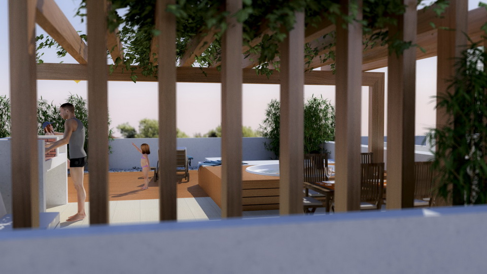

Re: Help to improve
and i think it work well outside too
