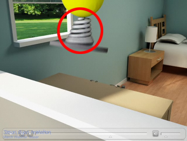

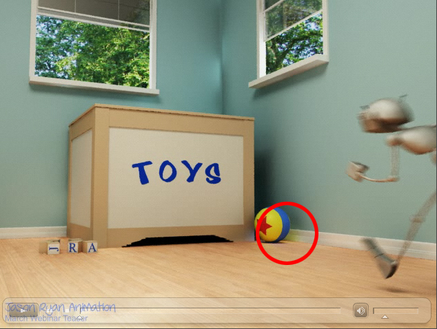

Here is a scene I recently finished for the Jason Ryan Animation live monthly webinar (http://www.jrawebinar.com) that I posted some questions about in the 'Help & tutorial" section (thread found here). Jason did the animation in Maya, which was then exported through Point Oven, where I modeled (not the characters), surfaced, and lit the scene in LightWave, rendering in Kray. This is my first usage of Kray for animated objects. I'm still getting the hang of it, but over all I'm happy with it (the .flv kind of takes away from the non-compressed version). I need to fix the lighting around the ball, but just ran out of time.

hi larry, the idea is very good but there's not a contrast in scene!!!
one suggestion:
the ball create a error on floor and wall
the piece of furniture need of best model design
the chrome of element isn't realistic...download the material in kray dep
http://www.kraytracing.com/new/distribu ... =10&t=1278

I'm not following you on all the comments, but I do agree with you on the toy box surface...it was very generic.nico wrote:hi larry, the idea is very good but there's not a contrast in scene!!!

sorry larry but my comments are for this particulars.
the anim is very good!!!

I gotcha nico, thanks on the spring surface, I'll work on that sense I'll be using this character for more animations. As for the ball, I noted that in my initial posting. I just didn't have time to figure out how to get rid of it. Any suggestions? It should be pretty tight geometry.nico wrote:sorry larry but my comments are for this particulars.
