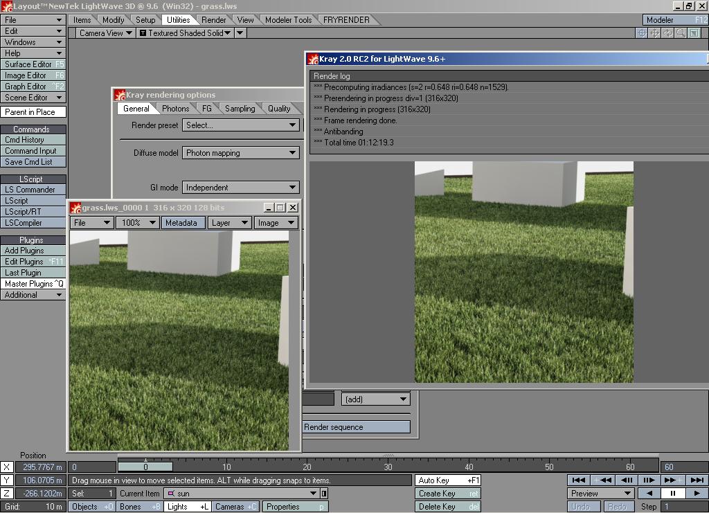

Wow Johny, incredible. I have to test more the last kray :)
How do you do this grass and stones on the floor with kray instance ? Do you use kray lwf for this renders, I like a lot the tone. Is there any extensive doc or tutorial about kray instance and kray lwf ?? I make some test with kray lwf but I don't understand really good this two plugins. One scene with little tests can help a lot. I read and print the wiki kray about this two plugins but I would see a good sample scene.
Johny_quick wrote:
This is my version small window part from big renders and my commerciall works (later I will show many exteriors with massive plants...)
Re: mediteranean villas
Ana028 wrote:Wow Johny, incredible. I have to test more the last kray :)
This is grass from this scenes:
http://www.kraytracing.com/forum/viewto ... =10&t=1498
For stones use small one stone and same idea from grass example.
I use 15-20 bounce with Power in Kray maximum 0.5 + Exponential. Power on Sun 4-8 beige colour. You have it in grass ver 2.0 - just put house, plants and chack result.
btw. You can clone all from instance, just made one layer points one cloned obiect, for leafs on gras next layer of pints and next layer with one leafs etc....
For tree I use null points after makeing null I clone only null points (later rotate small, resize etc) I know we don`t see trees in nulls but this is fast and easy for small or medium scenes.
It is very IMPORTANT put in exteriors many trees and bushes around scene - this block light from horizont and make good contrast in scene with deep shadows
Hi Johny, I render this scene and It's slow slow. It's correct the setup of the scene in the rar file of the scene ? The scene looks too simple but's when I hit the render button....
Ana028 wrote:
Good quality need long time render.....
