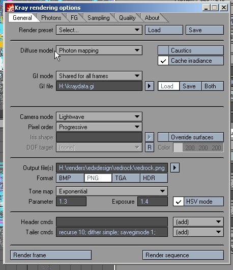

Ok, I did EXACTLY the steps mentioned above, and still getting artifacts and GI issues when rendering, any ideas?
file attached

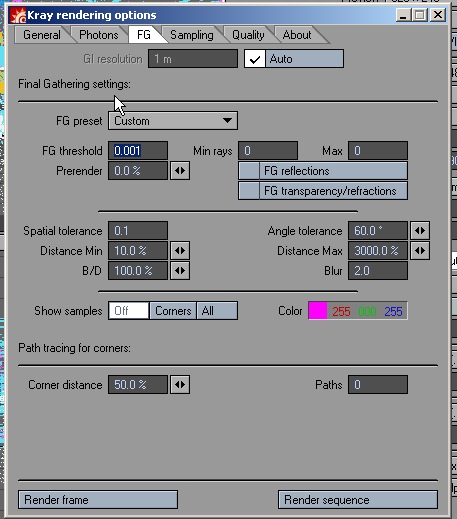

Hi mats,
Looking at your settings you have shared for all frames set at load, you need it to be set at BOTH for savegimode 1; for all the nodes to load and save to the same GI file
You also have set all of the FG rays and prerender to 0% therefore no new GI will be calculated, leave the FG settings the same so all nodes can add to the FG.
BTW you don't need the dithersimple command, this bug was squashed a while back (OB4 I think).
I hope this is of help

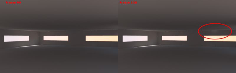

Hi Stuart -
I still cannot seem to get a clean GI for the anim..
I attached a small QT file, if you see the column inside the bar there is a flicker there.. I am rendering this on 2 exactly the same nodes, with the same settings that you posted.
I got rid of savegimode1 for the 1st pass and added savegimode for the second pass.
I am sorry but do you think you can post the EXACT steps and configs for both passes? I am cross referencing quite a few posts and I am not sure if I am missing something.
Very much appreciate your time Stuart !! Hope I can be of help in anything

Hi mats,
Other reason's for the flickering could be to do with different OS, LW, Kray versions and processors types of the nodes.
You could "override surfaces" and network render your scene to see if you've got clean, flicker-less GI.
I don't think I missed out anything in my previous post regarding the workflow, if you need clarity just ask.
I don't think the flickering has anything to do with the GI, the GI in the foreground looks fine. I think it maybe something to do with the reflective/ transparency of the surface's flickering, this is something which I've noticed becomes worse if there is a heavy bump map also. If you increase the blurring accuracy in kray and see if the flickering is reduced._mats_ wrote: I still cannot seem to get a clean GI for the anim..
