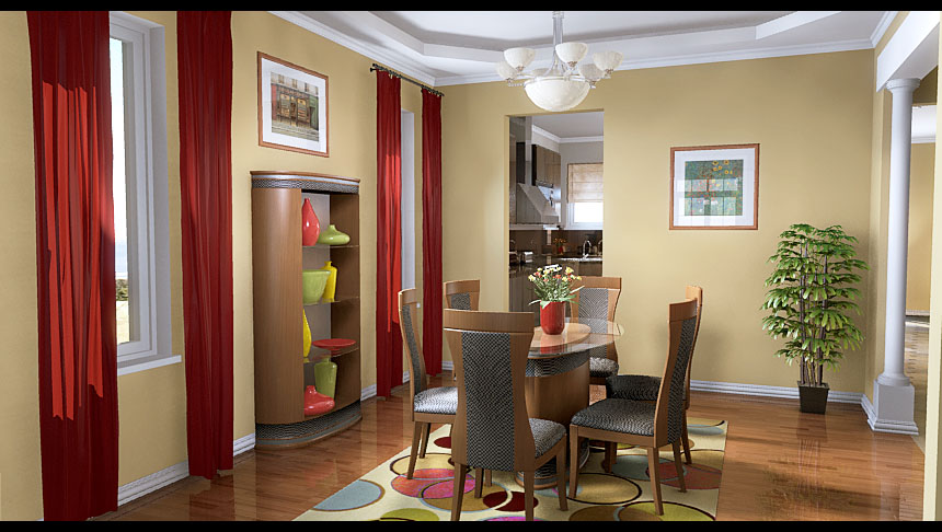

So i can make detailed comparison. But from my experience i can tell V-Ray is more universal. It allows to use most of Max features as lights with shadow maps,non-vray materials and so on. Way ago (in non-GI times) we developed a way to lit interiors in LW using lights with shadow maps only(i attached a sample of such render, of course it's not impressive nowdays, but that time it was OK) . It worked very well with animations. Main idea was to use group of lights to "mimic" indirect lighting. With number of inhouse scripts it was fast to setup. Then we transferred this workflow to 3D Max + Vray, replaced ambient group with low-res irradiance map. This worked well.. OK quality, very fast render times, fust production time. With Kray we have less space for faking something. but seems it has world fastest blurred refletions in the world :)

LW render of interior lit w/o GI, just shadow maps.
