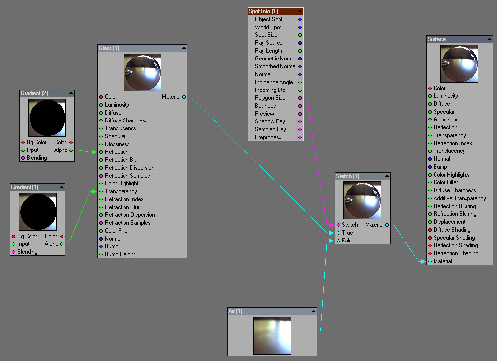

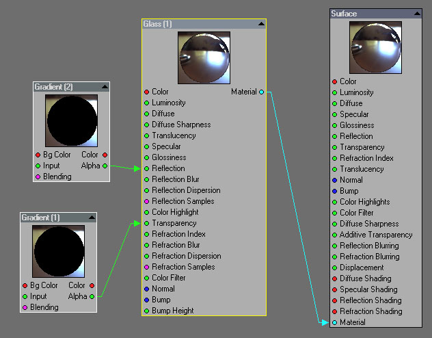

Post by direwolf »
Yep, you're right. I meant the incidence angle. I've attachted two screenshots. The first (named 1.jpg) is my material as i would use it in LW. The second is an lighter version since Kray doesn't need the spotinfo for airpolys.

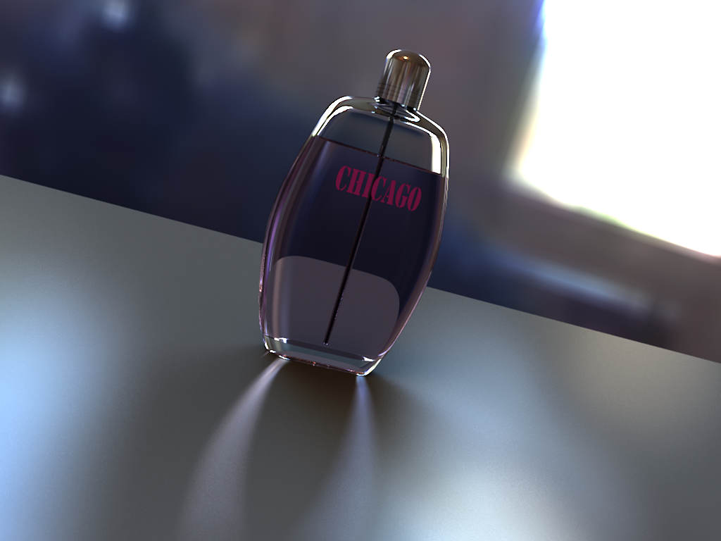

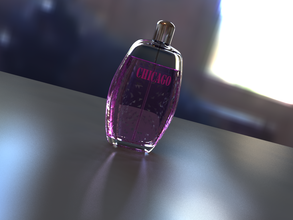

Oke, more issues at a "fun-project". This time, i've set up my glass using the old-fashion surface editor. I get strange triangles rendered out of kray.
These do not appear in lw. BTW the object is a frozen subpatch (poly only therefore), 'cause of matching the liquid with the glass.
I've attached two images, a lw and a kray render, all the same settings.

Post by phile_forum »
I've also seen triangles like that with Kray renders. I've got rid of them by freezing the model at a higher level of subdivision. This is not really a cure - I suspect the triangles just become too small to see - and it slows down rendering of course, but it does mean you can get a decent render.

acidarrow
Posts: 140
Post by acidarrow »
Are the polys coplanar? Try scaling the liquid up a bit and re-render it.
