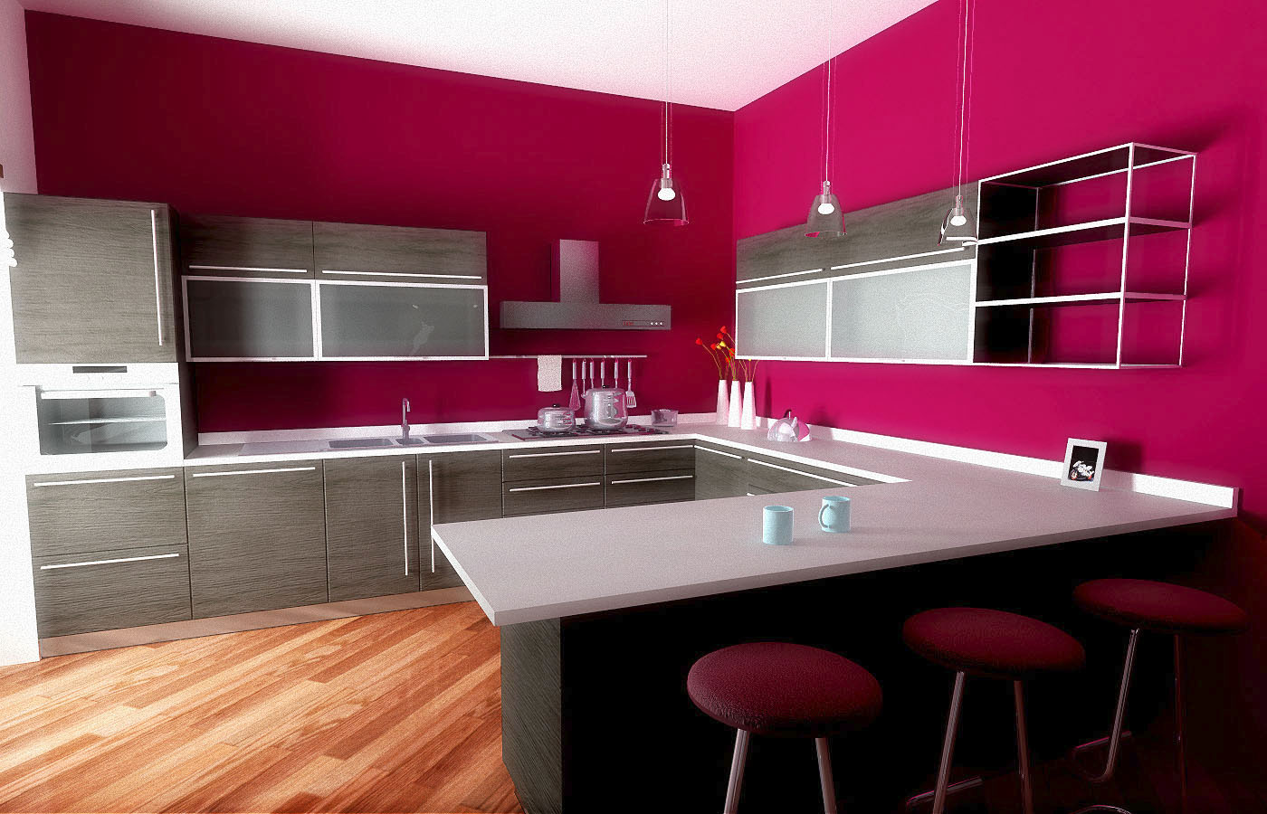

Here is the render with Jure tips (but I don't delete arealight) 6h 15m!
Next render with Johny_Quick tips!
Thanx
pienri wrote:Hi Johny, thanx for tips and the image, you think to use only Hdri image or Hdri+arealight?
I use combo: HDRi+Area light+sun distant.
Use in Tailer command: "recurse 10;" to limit bounce light. Dont use recurse 1-9! - this destroyed bounce in glass (black colors on the glass). Recurse 10 is very good.

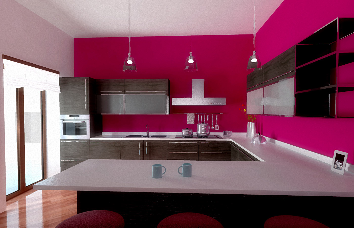

another render, time: 6h. (jure setup + arealight)
Why is the render looking a bit noisy?
Those render times can be improved IMHO. Can you post your settings and your precomputed render?

Hi Jure, escuse me for long silence time, but I have to work hard for other projects.
The settings are the same I posted, but I turn down B/D to 100% and grid 3 full screen AA like you suggest to me.
The noise on the last image is for the postprocess, the original render is clear. How can I improve render time?
