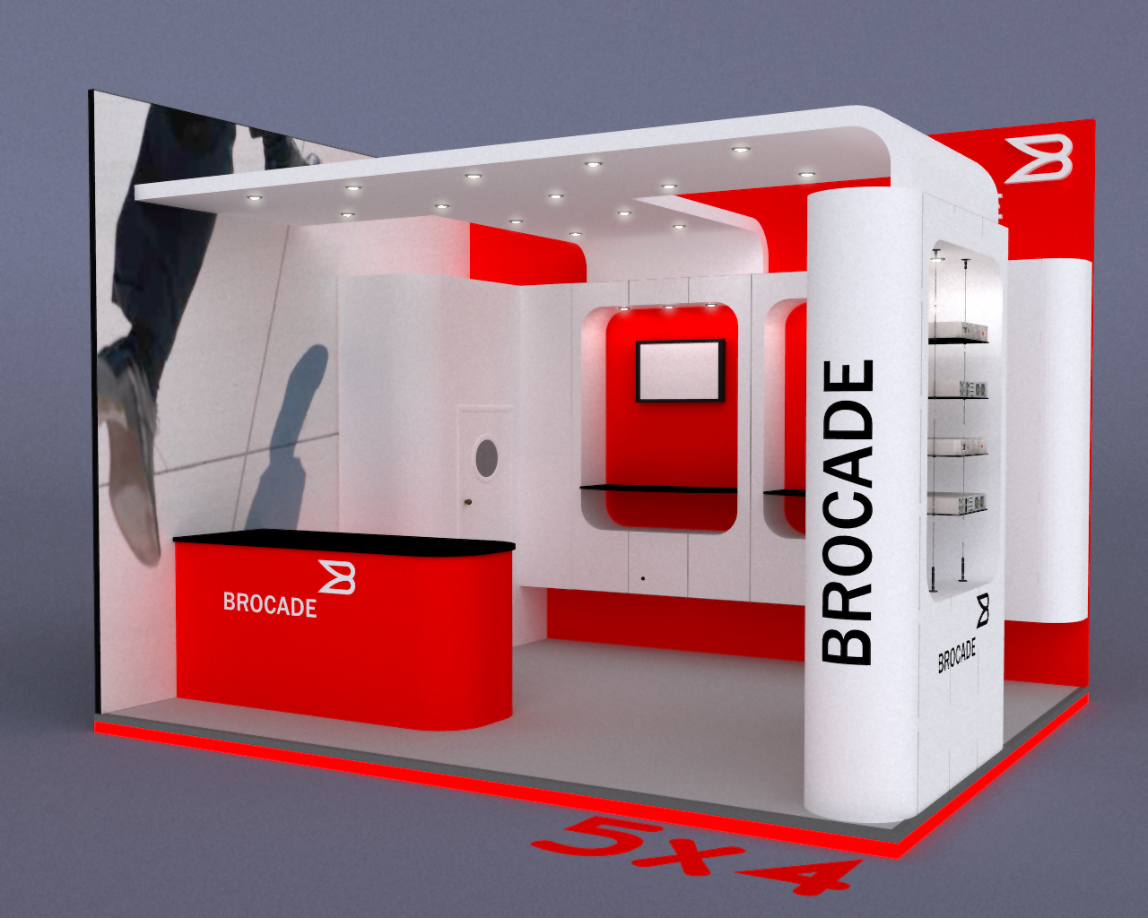

Here's my first test. A little dark also the background image is missing?
Any thoughts?
Also how can I boots the surface based lights range & fall off?
Shaun.
Posts: 453
Post by silverlw »
Are you using lightmapping? If you use photonmapping you need to add the backdrop image on a plane or sphere to make it cast photons.
Nice scene overall but AA suffers. Try Pixelfilter "cone" and try a filter radius of 1.0-1.5

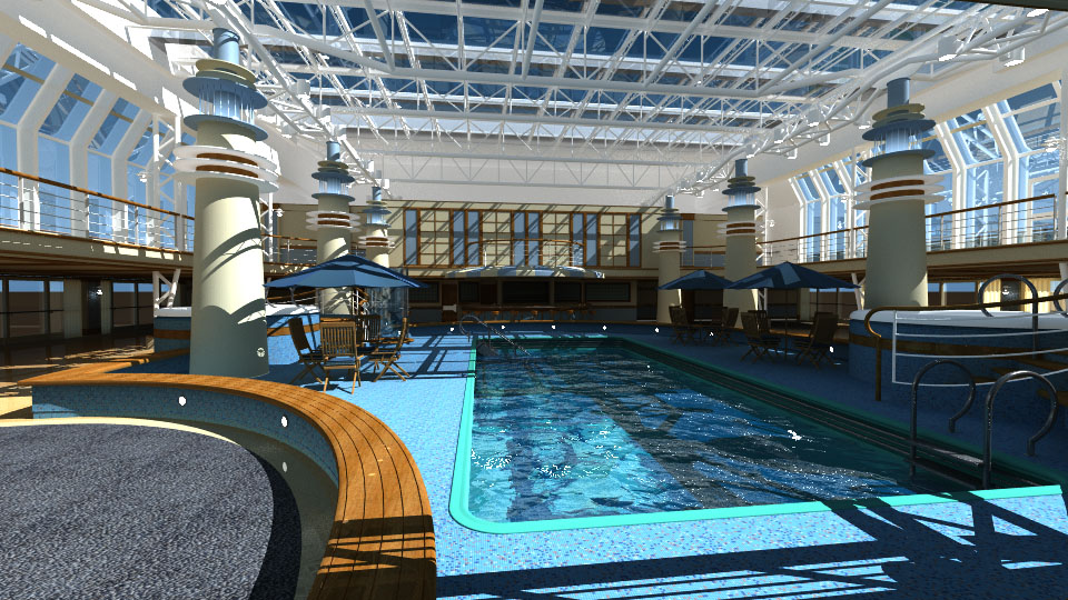

Here's my next image. I had to run a noise reduction out side of Kray.
The scene has no lights, it lit by a background HDR image & surface lights.
With out hitting high render times what the best setting to reduce all the noise?
Shaun.

Are you doing uncached renders? Using cache irradiance will eliminate all noise..

AcidArrow wrote:Are you doing uncached renders? Using cache irradiance will eliminate all noise..
Cool, I'm not. I though cache was for animations... :oops:
