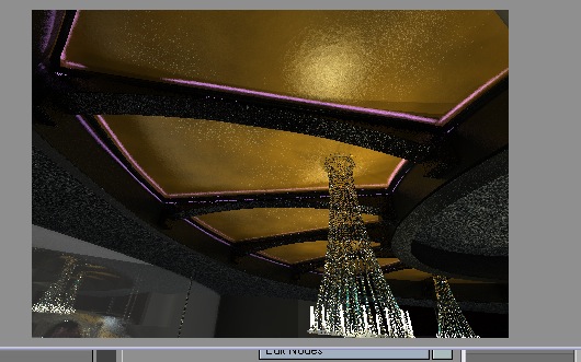

I am trying to simulate this recessed back lighting, I have created a molding element and placed a 300% luminosity tube inside, I cannot get the light to spread out far an nice though, any ideas?
I played with some settings but it does not seem to work?

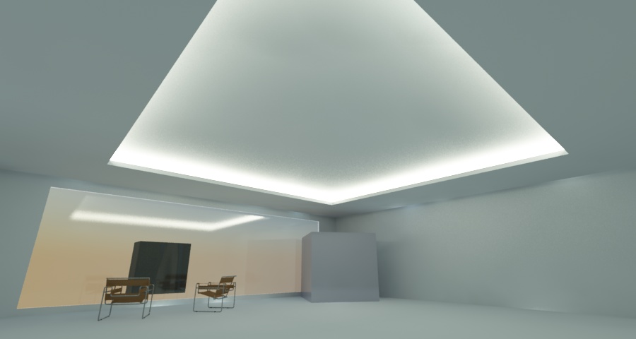

Well, a luminosity of 300% is fairly low. You could try turning it up to 1000% or so. Also, it may not be necessary to use a tube - just paint the wall polys up there at the back of the recess in the luminous colour.
The illumination will be grainy, so turn up Rays Min & Rays Max (next to Luminosity threshold on the Quality tab) until it smooths out a bit. Quasi-random AA will also help.
Phil
EDIT: Example render & Kray settings attached. It doesn't render quickly, and there are still some nasty blotches to sort out. Four 1000% luminous polys up in the recesses.
I guess if you didn't want to go to the trouble of actually using the illumination, you could fake the light creep across the ceiling using a weight map to control luminosity (set at 100% or so)...
Phil
