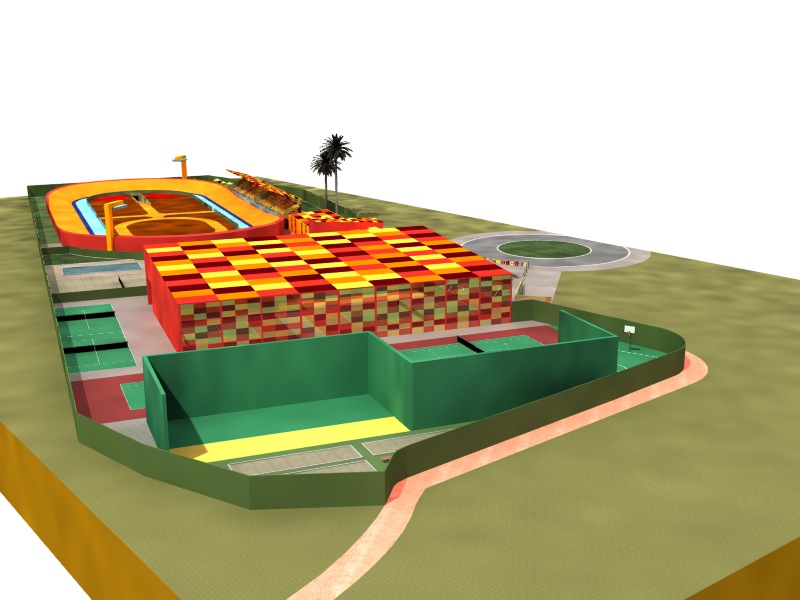

Hi Jure, thanks for your advices, i post you here what i got, but I have also two questions, i can't get transparency like it should be in the outer green wall,.. and also can't get instances of the palm trees, I tryed naming my null with the same name as original: "PALMERAS VELODROMO:layer2" is there something I've done wrong with exterior scenes?

- kray_render00000.jpg (91.46 KiB) Viewed 4695 times
Hi juli51!
Your image has splotches because your irradaince is not smooth enough. Increase N and/or precache blur value.
What kind of transparency are you looking for? What settings yo use now?
Here's a short instance how to:
Say you have object myobject:layer1.
To create instance of this object create a null named myobject|layer1
Note that "|" replaces ":"
If your object has only single layer i.e. "myobject" then your Null should be named the same "myobject".
So in your example you should name your null "PALMERAS VELODROMO|layer2"
