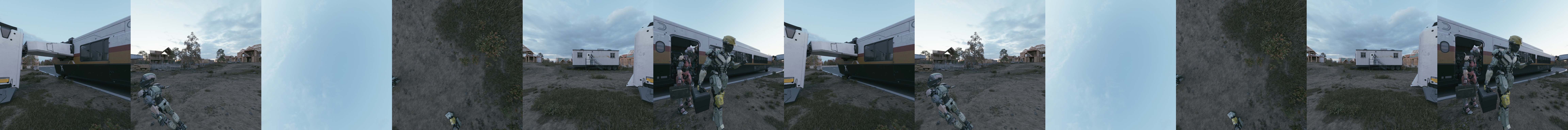

Here is correct stereo panorama in tile system (it is doesn't matter what system we use, I prefer two panorama Left/Right near each others - is much cleaner information) You can check this is Oculus or HTC

Lately we also need Stereo Panoramic images so we can faked it a bit by Ubercam using stereo panoramic camera (this is no Rig!).
The effect have full stereo on the north, west/east loosing stereo effect, south crossing left/Right eye. It`s gives stereo feeling in around 180 degree.
