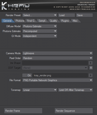

if you have 3 computers (equal speed) is good idea to split animation. For example:
- 0-120
- 100-220
- 200-300
In AE you just overlap them with minimum 20 frames.

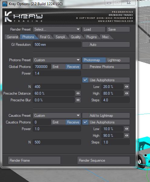

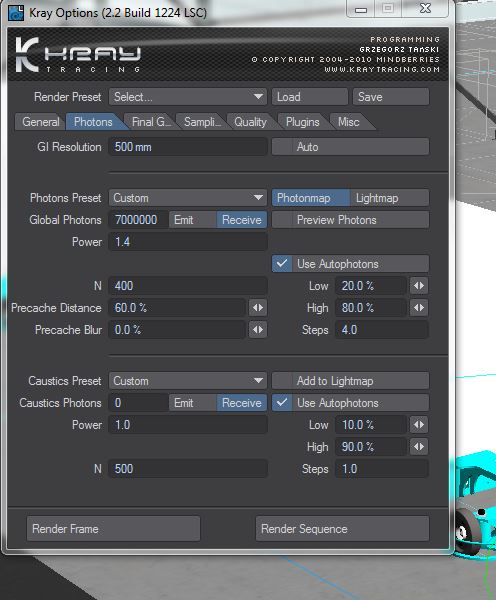

Theses photon settings i´ve used so far

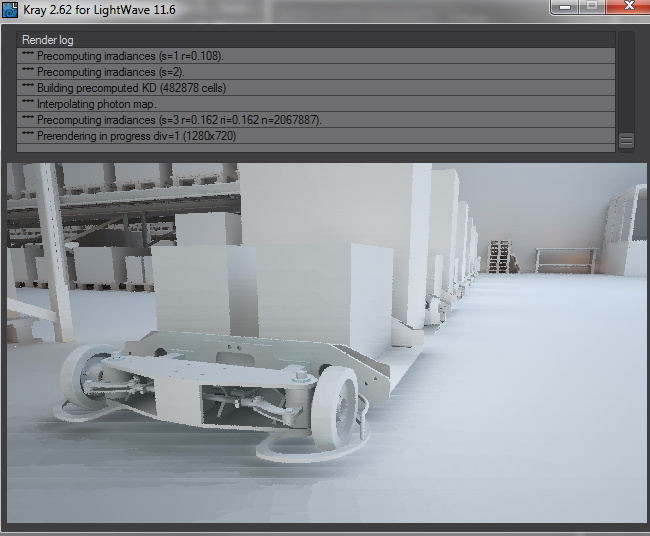

I see in animation some "Hot Photons" problems (I suspect). Can you render every 20 frames Prerender precompute? :
It will show us what happen with Photon Map. These "blinking" comes from huge photons power shots.
Of course each frame will have random and different photon information but for for us is more important how they look (cells)
At least in override mode whole GI start be good. One more thought: the object and camera move fast - this can be also problem for Time Interpolation because there is no space enough to blend frames. Between frames are simply too big changes...so probably we can do nothing with this, although you will make animation more "smooth" with camera and moving objects (less speed :wink: ).

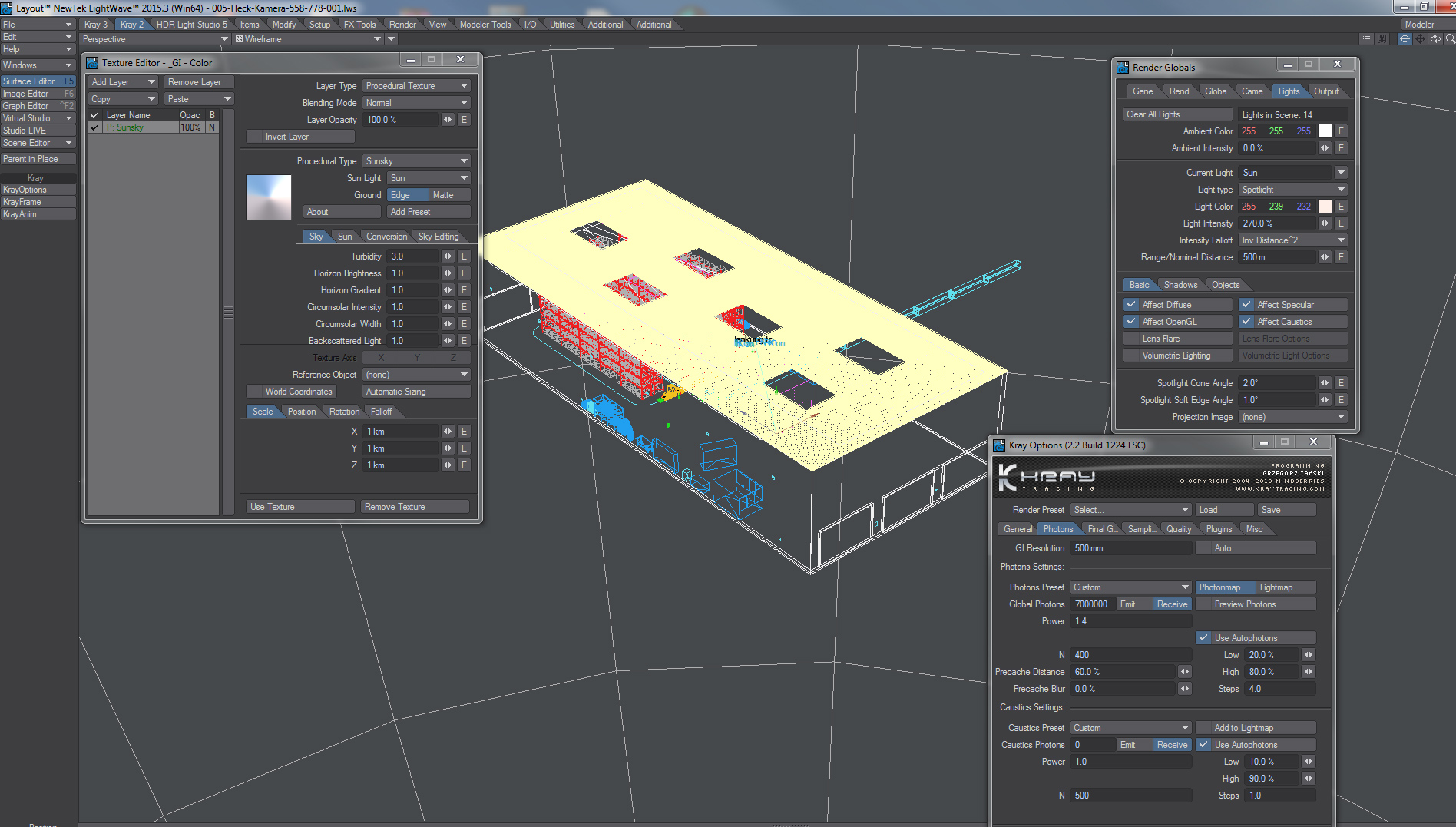

My Setup is based on dp sunlight and a GI dome with Sunsky.
There are Light portal polys in the roof. But i have just seen that "Kray LightPOrtal Shader" was twice
in there and wrong light applied....hmm.
I try one more preview
Re: Animation
Ok now I see problems:
1. Do not use DP Sun Sky plugin: slow render, not supported in Kray.
2. Forget SkyPortals
3. Instead of PhotonMap use Lightmap - this is because you have huge space to fill up and using PhotonMap make this mission almost impossible in K2...you have to shoot at least 20-50 million s of photons. Also Skyportals not work with all light sources and perhaps you not get any photons from DP Sun (I am not sure with this)
4. Precache distance should be 100%
5. etc

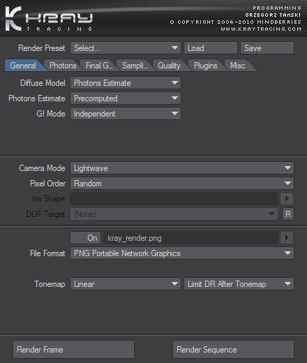

Just use my Kray settings + my light system (I use it also for normal interiors):
Fill_Light_system.7z
(1.42 MiB) Downloaded 2391 times
Use hidden LEM on the roofs but remember to add 50% transparency for them (I have to post to G. BUG with blocking no interpolated photons by hidden LEMs)
This scene is simple and should not be problem with animation at all.

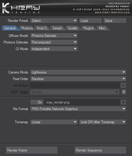

The best setting for K2 is simple. This is minimum quality:
Kray_setting.lws
(10.44 KiB) Downloaded 2109 times
Use load Items From Scene (so will be also tone mapping include)
