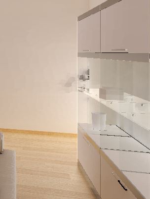

Hi Kray friends,
does anybody know how to fix this problem during prerendering. There is glass and behind I can see some black spots on the wall.

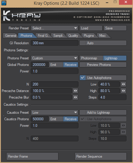

Hello!
Try:
- increase amount of photons in Photon Tab. For example I use minimum 2.000.000. it is maybe a lot for small rooms but G. told me last time: then more the better for averaging information Photons cells. Here good setting for Photon Map: - if you use Nodes turn OFF them ...maybe you use something unsupported
- if you use Dielectric Node change it for another system of glass
- all the time with problems in render use analyse tools: it will show you errors from Photon Map side. If Photon Map is correct (photon map has good quality, gradient, no black holes, no missing photons) then problem is elsewhere.
						Try:
Re: Prerendering issue - black spots
Thanks Janusz for your tips.
I found out, that when I switch off reflection of the glass this problem disappear.
Glass node (standard) creates this problem
Dielectric material is OK.

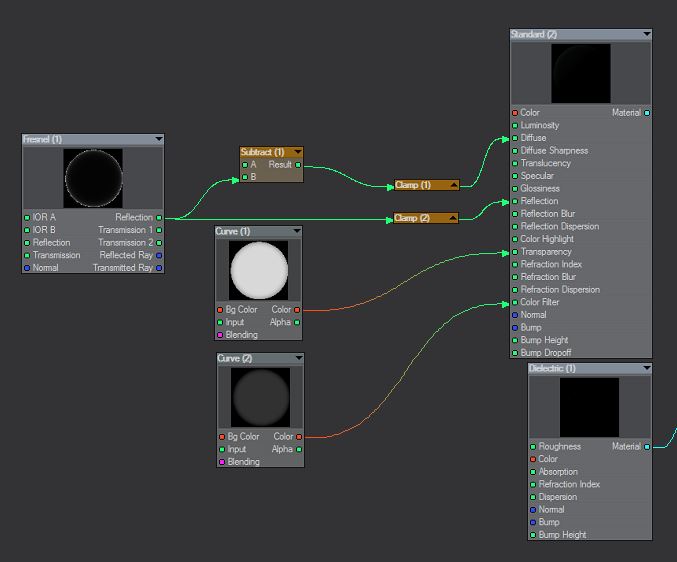

ok!
I suggest not to use Dielectric Node - it affect errors in Photon Maps (very strong random Hot Photons)
Here my glass Node:
Please notice bump map is in Y direction stretched very strongly (it is no mistake)
Also if you need stronger color, simple use color filter (the more the less transparency will be glass)
Do not use Refraction Index for windows glass!
Windows glass must be always in separate layer with Raytracing flag + of course no shadows.
You can add Refraction Index then will be glass for "glass effect"
Inside Node is limit up to recurse 6. It is enough but sometimes when is scene with many layers of glass you must increase this value up to 10-12.
Here my glass Node:
Thank you very much. It works like a dream.

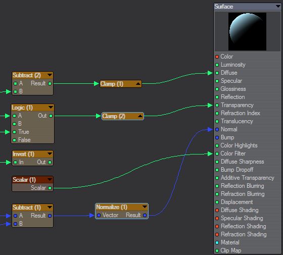

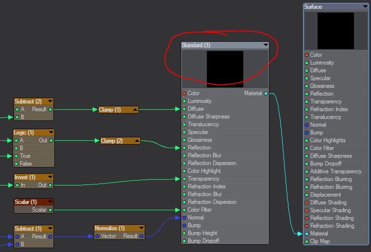

I found out, that if I use Standard material node it creates problems in some cases. Do you have the same experience? We use it very often to have one material set-up for LW (Kray) and Octane.
Jarda_viz wrote:I found out, that if I use Standard material node it creates problems in some cases. Do you have the same experience? We use it very often to have one material set-up for LW (Kray) and Octane.

Hello,
thank you very much for detailed explanation.
I tried last time this node set-up for the glass and it created above mentioned problem (black spots)
If I connect it directly it works well (second picture)
I had a problem only with glass surface so far. I have to test, whether this set-up could be use or not with KRay.
Use only direct connections. Also be careful with compound.
