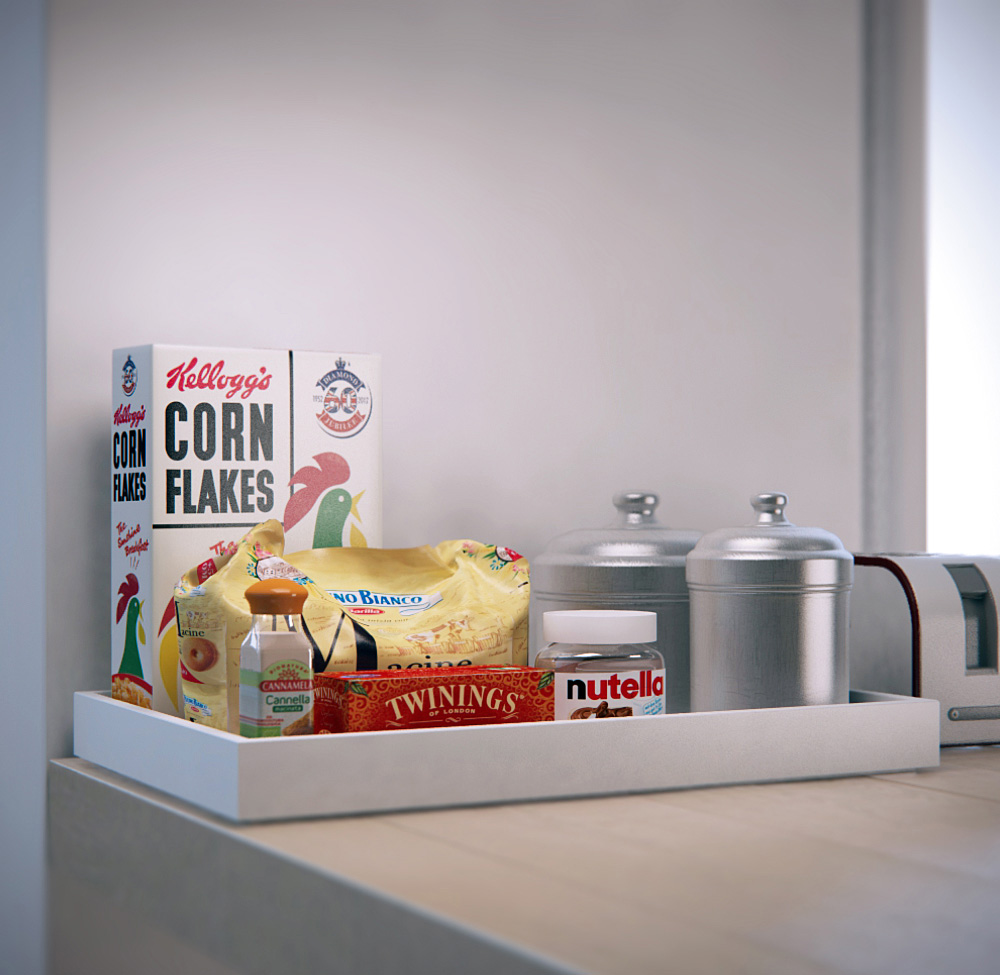

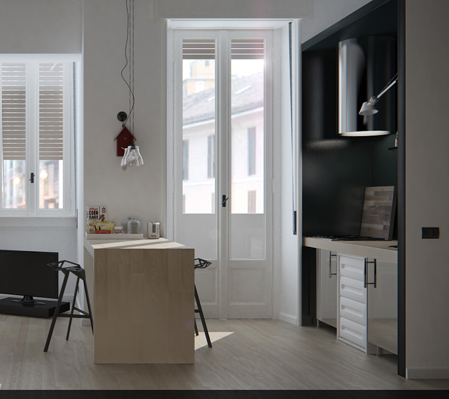

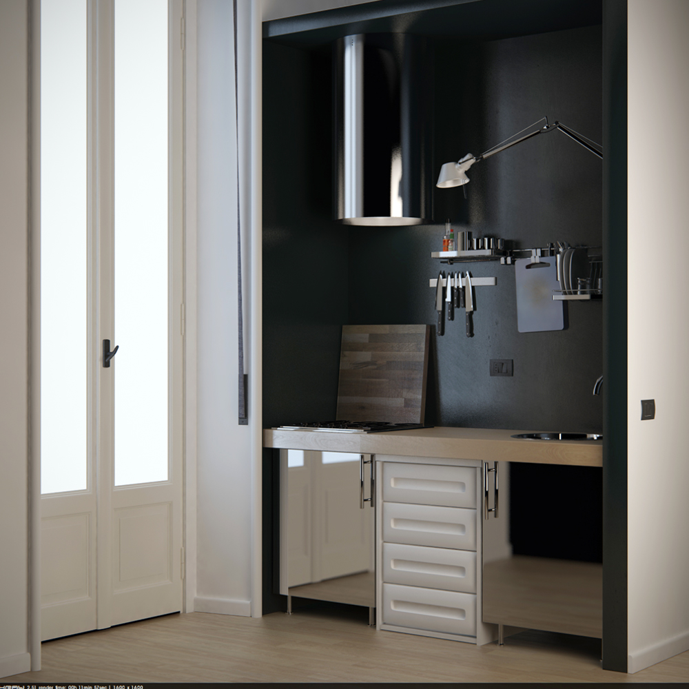

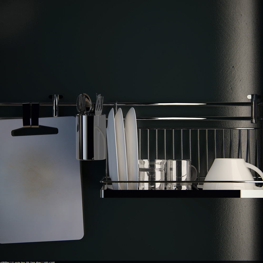

hello everybody,
having some free time to spend I start to model and test render parts of my house,
I have to say that this could be a very interesting exercise in order to improve modeling, lighting and surfacing
scene is lit with 3 lumipoly and kray setup is a basic lightmap setup
models are 95% self modeled
I've updated some views, I'm near to complete my livingroom/kitchen area
(I'm lucky 'cause my house is small!)
waiting for your comments
thanks
Alberto
thanks
Alberto

Re: my house
For me the best stuff ever
Very good materials which are the KEY to High Quality
Re: my house
thanks Janus,
your positive reply is a very good motivation to go on with the rest of the house...
I absolutely agree about material definition...and I've seen also that detailed modeling is an important key to realism..
about materials we absolutely need anisotropic and SSS!.. and I'm still waiting for K3
do you think that we can reach some results just with playing with nodes and k2.x?
thanks!
Alberto
thanks!
Alberto
Re: my house
Yes this is KEY to render : Ultra Surfacing. Everybody think about: Maxwell or V-ray - they are good...but is not true..the surfacing is perfect (Nodes or Shaders). Gi you can get exactly the same as in these software. Only missing part is surfacing.albertos wrote:thanks Janus,
thanks!
Alberto
Surfacing means Nodes...and is no another way. Surfacing means multiply in Nodes many textures to receive realistic surfaces and use Fresnel with injected reflection map and inverted blur map + exclusion of diffuse. This all is easy and doesn`t need shaders. they are math operators.
Only missing part are:
- SSS (In this case I will not go to real SSS, is not necessary...better is to add special shader which make fake SSS but is much faster then real)
- anisotropic reflection (this will be 100% for sure - is so needed in renders. This shader from LW Nodes is emulated so is slow and noise and is nonsense to use it in Kray.)
- displacement (why I do not render exteriors - because whatever I want to do is about to use this function)
Three above thinks we can not avoid now . So we must wait for K3.

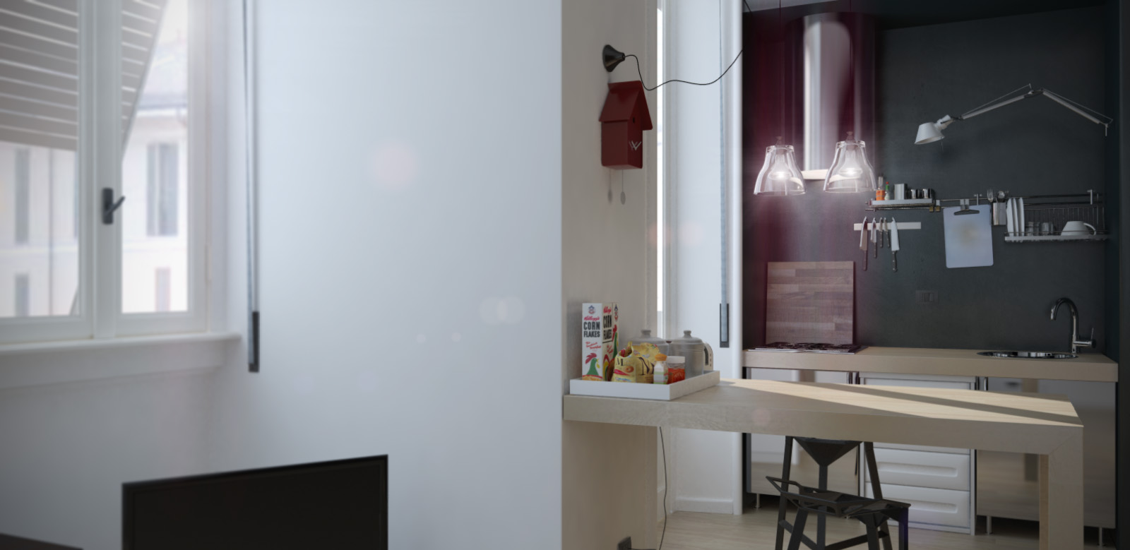

Re: UPDATED my house
Now I see you updated renders
Very good stuff
...surfacing is the key for high quality.
Very good stuff
amazing!!! this is really great stuff!
nice update
