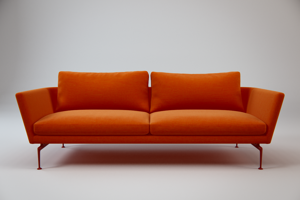

9. 4000 pix studio you can render in 1h (i7 CPU 12 HT) depends from object of course. This my sofa render was 8 min.

Here my test from this Idea , again previus scene but 3 times faster then before! (apparently old Kray is DAEMON of SPEED in QMC :shock: )

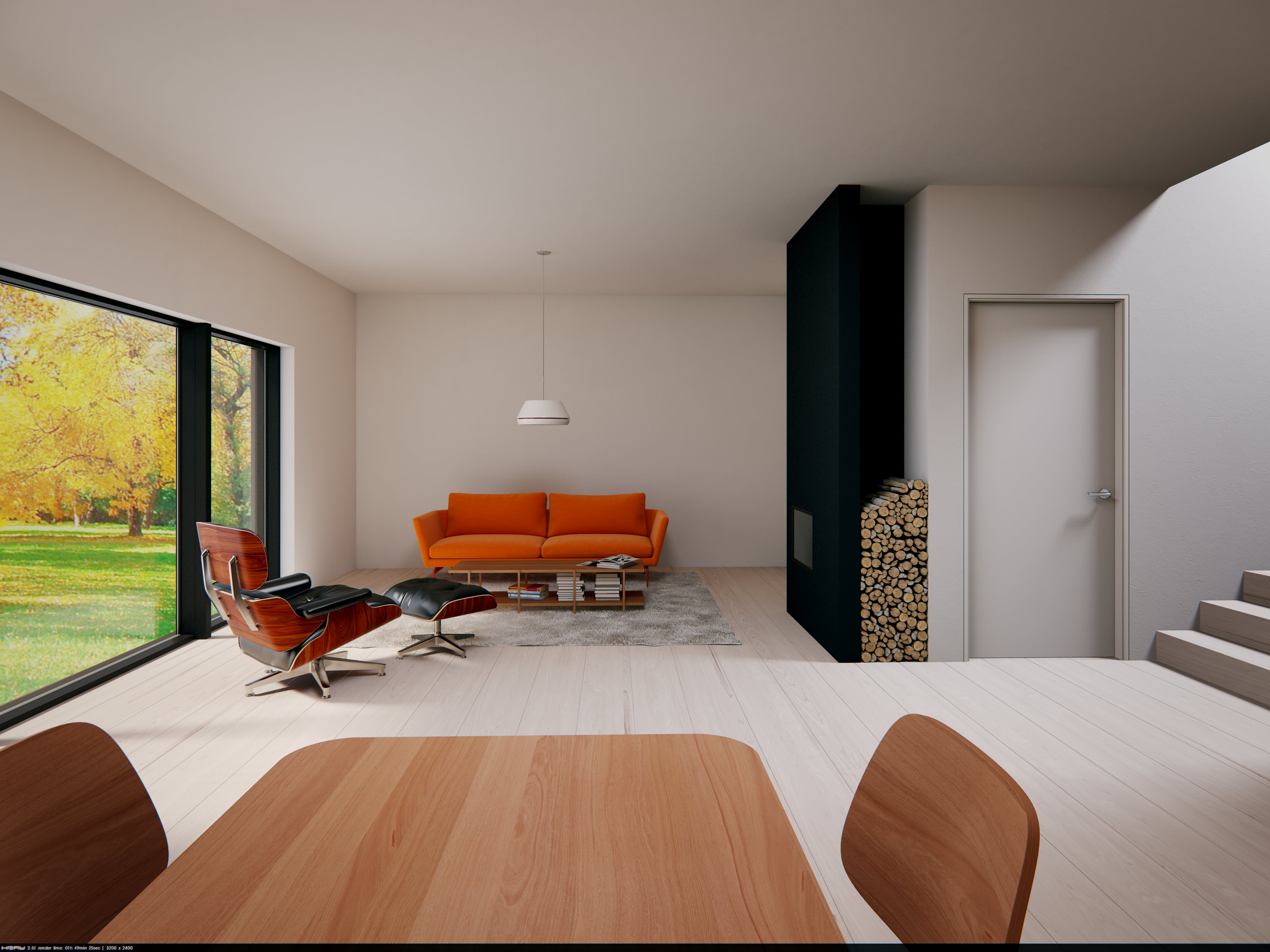

This setup is for studio. For interiors you need increase more FG min/max (500/500 minimum). Also Area light min/max 3/4 is enough for good quality.
I try also this setup with lumi panels and I want say looks also good. I know is slow (not that much) but with Final Gathering is impossible to achieve that good GI.

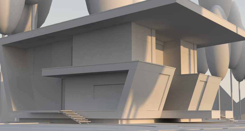

Here my test for exterior (Maxwell Path Tracing/Kray QMC 12 recurse).
If somebody is interesting in, I will post this scene for tests. If somebody will watch carefully then will observe are not differences between Maxwell and Kray (of course Path Tracing is the best and is nothing to compare with QMC ) The time is twice faster...hmm not profitable but is one trick: in scene are not textures, reflections etc so in full render the difference will be huge (I think 5-10 times)
