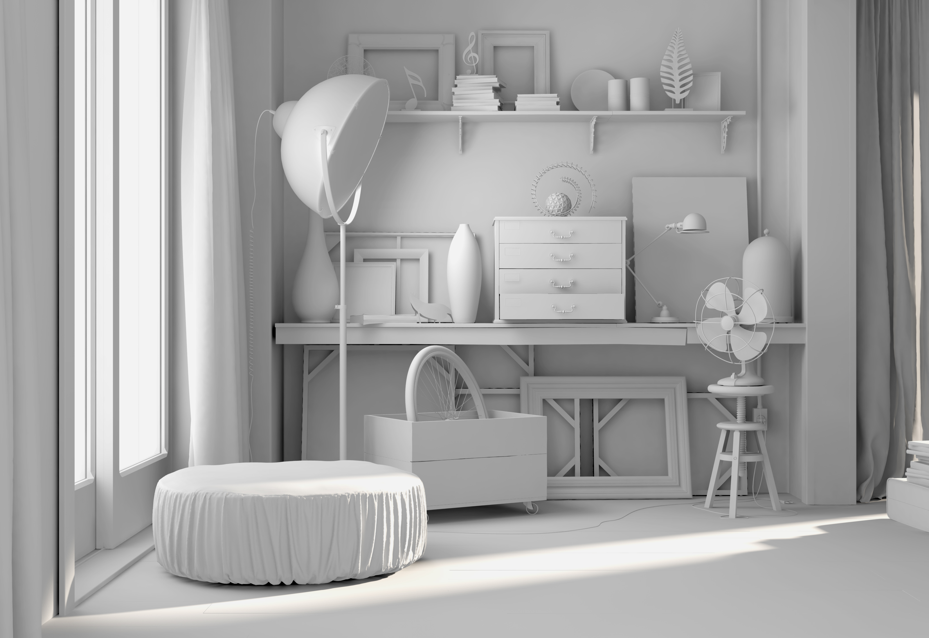

bed room Nodes test
bed room Nodes test

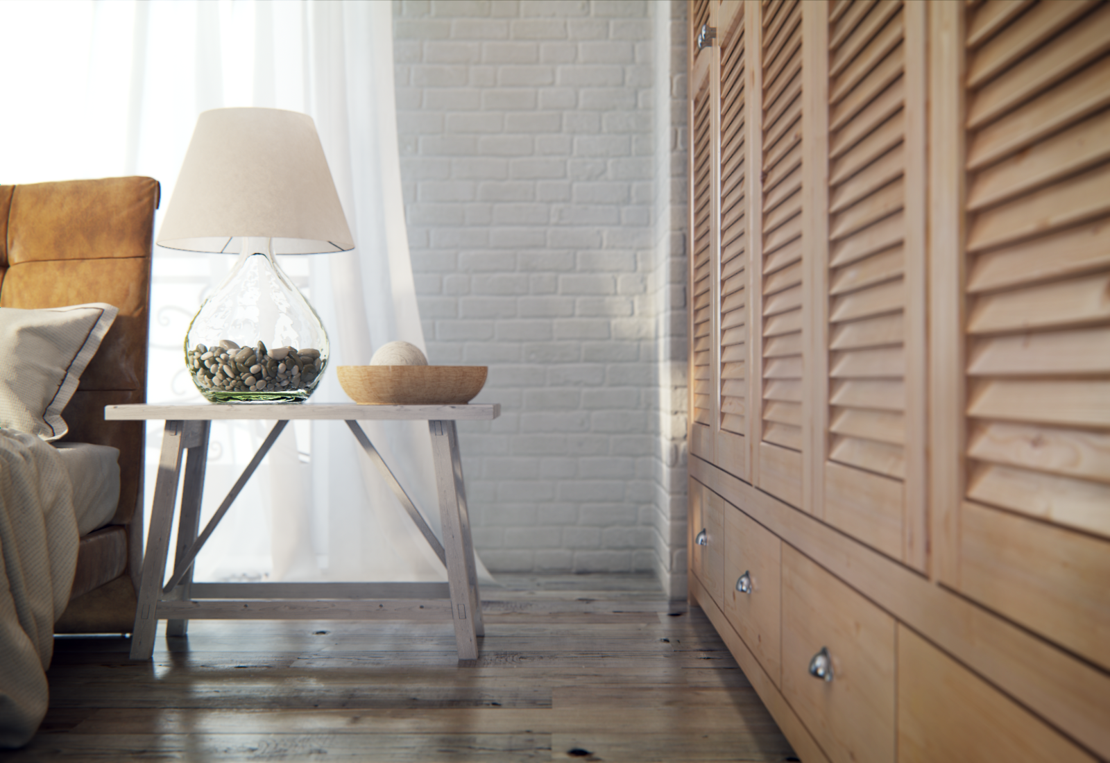

My new test of Nodes in LW (all surfaces done only inside Nodes). Scene I converted  from V-ray...so only original are wire and textures.  Time render 1-2h i7CPU.
In scene only Sunsky + SunSpot (no extra lights in windows) and sometimes light from big lamp. Photon map was corrected by Kray Skyportals.

Looking very good ...
I know the original scene and it look no less good. but i have sone question  about your work that intersting me:
- can u share your setting about Antialising because in your scene it looks very good.
- about nodes...where i can learn how to control that monster. always when i open the nodes panel it look that i'm loosing control there with all the options etc...
-can u share some basic shaders of your ... ?

damn, you are good!
any chance of sharing the whole scene? I know that your knowledge is your 'secret of the trade' but since our community has practically no tutorials - (probably because we are waiting for kray 3.0 ... only god knows when will that happen) - i think that this is the only way for others to learn kray as good as you. What do you think?

AA setup I posted many times...but again (please read forum careful) FSAA G3 Quadratic 1.0 + if You have problem with high contrast regions - Limit DR before tonemap. Also resolution is important under 1000 pix always You will have problem with bad AA ...because this is normal (doesn`t exist good AA pixel engine. All renders engines has problem with AA in small resolution) So I suggest render in HI res all the time.rosstheboss wrote:

How come are u using krayskyportals again after having prevoiusly said in some occasions that they were not advisable ? render are done with lw11.03?Janusz Biela wrote:My new test of Nodes in LW (all surfaces done only inside Nodes). Scene I converted from V-ray...so only original are wire and textures. Time render 1-2h i7CPU.
I mean those render setting are very different from the ones u have followed so far
Re: bed room Nodes test
Yes I backed to forsaken Skyportals and apparently they are the best! (I knew they are the best ...but not that! especially in complex and heavy scenes ) ...somebody will ask why? Well , is a lot to say. After K3.0 when I will make video tutorials , everything will be easy to understand. Now to use Skyportals is very difficult, and perhaps ONLY I can use this in correct way. So better wait for my video tutorials for K3.0
 After K3.0, use Skyportals will be the best way to receive high quality photon map, which is necessary to render fast and clean. Now with this function I receive incredible clean photon map which affect much faster render, much cleaner and much accurate, but I repeat again: Skyportals are very difficult to use , especially when we have some additional lightss inside room...You must use another shaders for control balance of light, etc...
