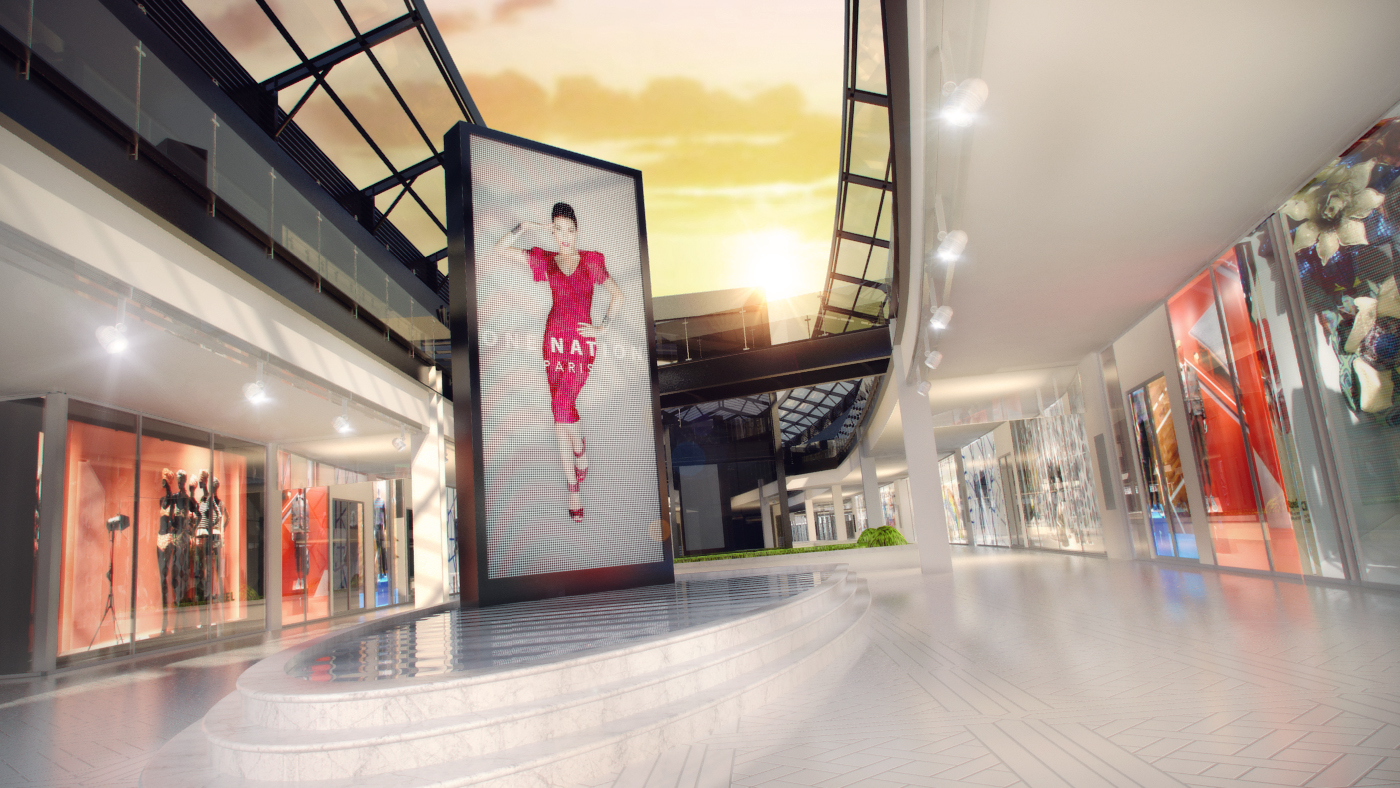

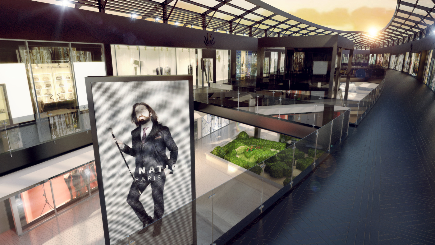

Rendering for a mall in France.
I used Kray 2.51, Lightwave 11, VirtualRender.
VirtualRender helps to render faster, it's very nice!
I'm no an expert in setting up Kray, I gathered many of Jure and Janusz advices in a document and that helps a lot!
What might help is to get in the manual the average values that we use (from x to x).
When we get into Kray,most of the time we don't know if a value needs 1 or 10 or even 100000. It's as important as knowing what does what.
Using VirtualRender avoids getting the passes.
The Alpha channel of Kray is messed up, if a window is transparent and an object behind is opaque, alpha channel will put transparency where the window is without taking in consideration the opaque object. So I can't use it for production.
I hope all those limitations will fade with Kray 3 even though I love it still.
