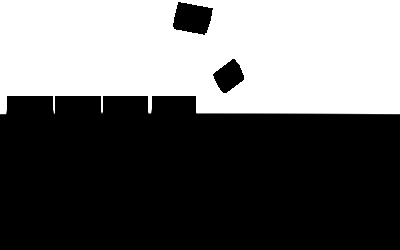

Tried everything tga,png. When it gets to the part with depth the AA is not there.
kray_render00150_zbuf.tif
kray_render00150_zbuf.tif (99.83 KiB) Viewed 7854 times
Re: z depth with no AA
Change your Z buffer settings to Clip front: 0, clip back: 50 or something like that...

That worked. Thanks. Is it possible to have realtime preview of zdepth in kray similar to extrader? Or is it for kray 3.0? :mrgreen:
