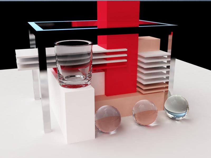

Posts: 453
Post by silverlw »
here is the glasobjects with one glassurface only. The drinkingglas uses the same material as the balls. Kray understands automaticly what is the drinkingglas outside and what is it's inside and do refractions correctly.
