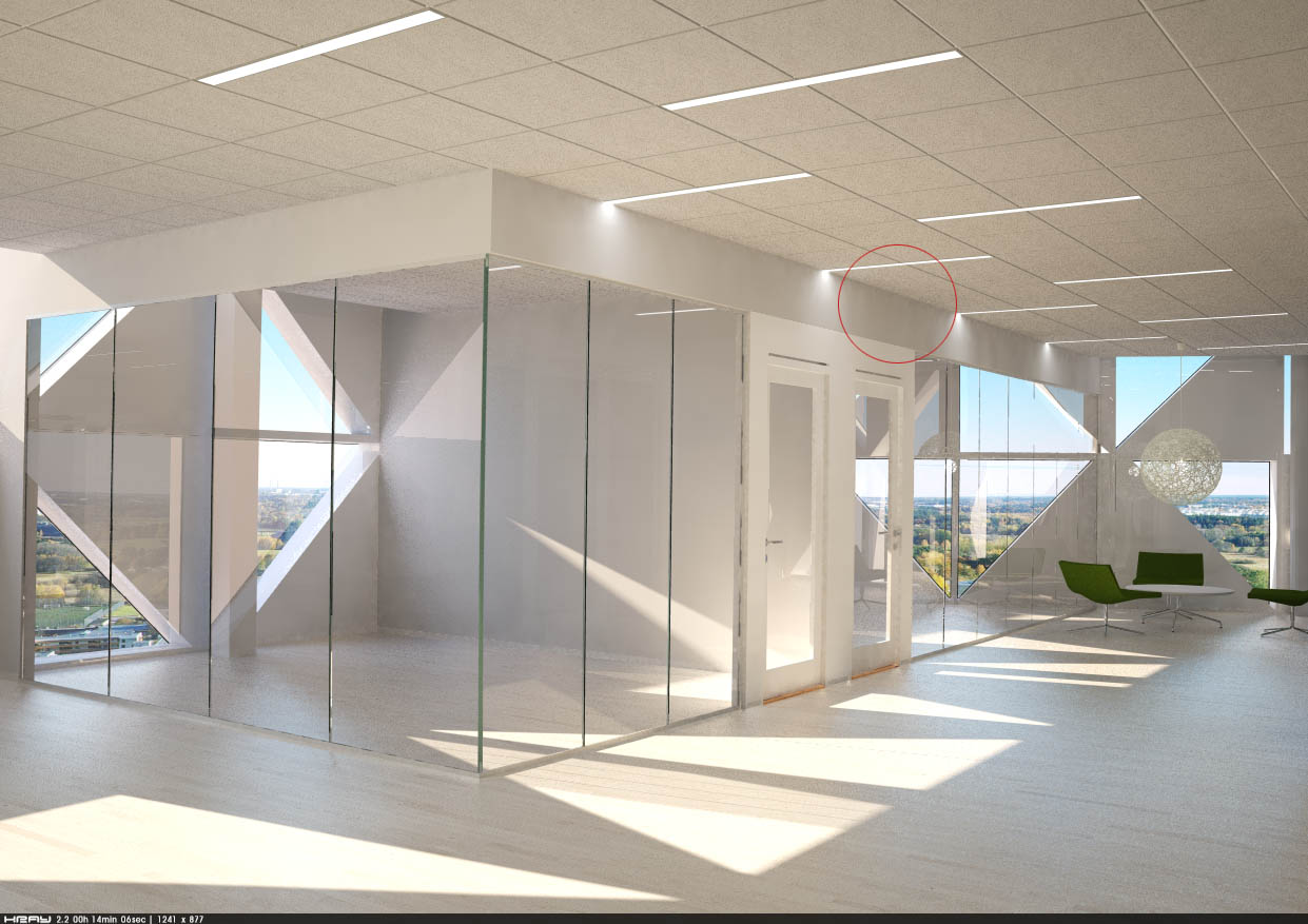

Would need help to get rid of those dark shades in the corners between walls and ceilings.
Does anyone know how to get an evenly toned finish on the wall.

Hi,peol wrote:Hello
Sincerely,
Peter
on FG tab try Path passes 1 or 2 and distance ~100%. Also increasing min/max FG rays can help. Also check that your photon map does not contain any major splotches.

I have now changed the settings and it looks much better.
Thank you for the infromation.
