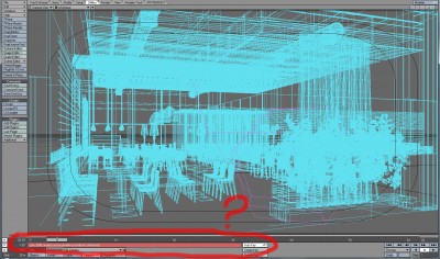

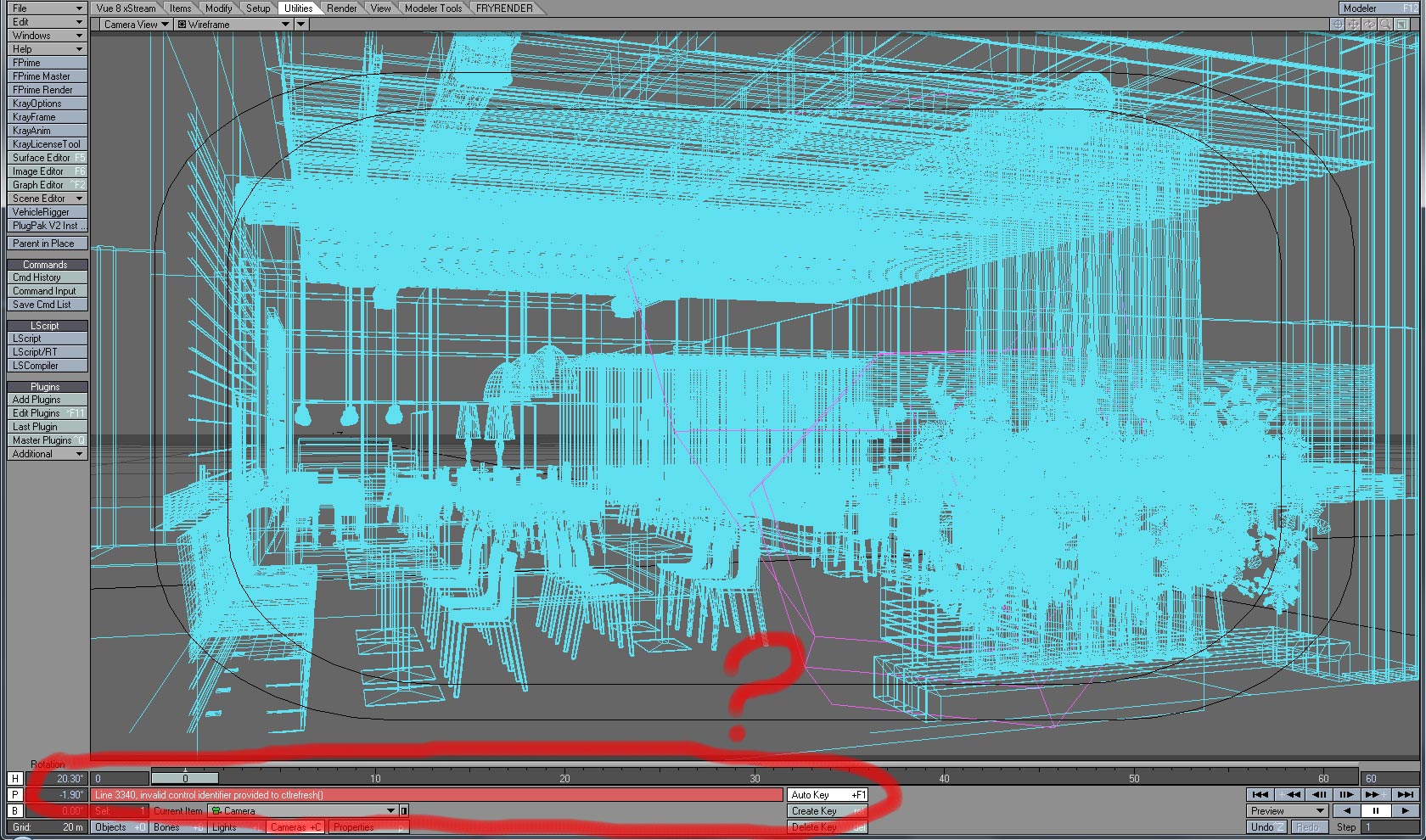

kray 2.1 fix problem help please:!
Re: kray 2.1 fix problem help please:!
I had the same problem after having made deep changes to my scene.
So I loaded the previous settings, saved and rendered again.
I suppose that the word "refresh" in the alert message is the key to this bug.
Unfortunately this is LW lscript bug and not Kray bug so there is really not much we can do about it but complain to newtek. We have opened the bugfix request long time ago but untill now nothing has happened yet. https://secure.newtek.com/FogBugz/defau ... 26248_ff9u
This problem happens on x64 systems when there are a lot of objects in the scene. Once you start getting this error you need to close layout and restart it. If this doesn't help you need to reduce number of objects in the scene and that usually helps.
Anyways we will drop Lscript in future and use our own code for the interface because Lscript proved to be too buggy for complex scripts.
