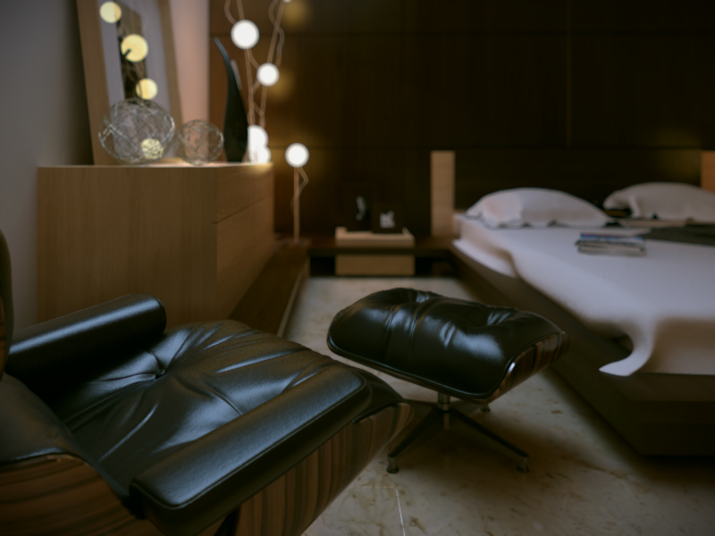

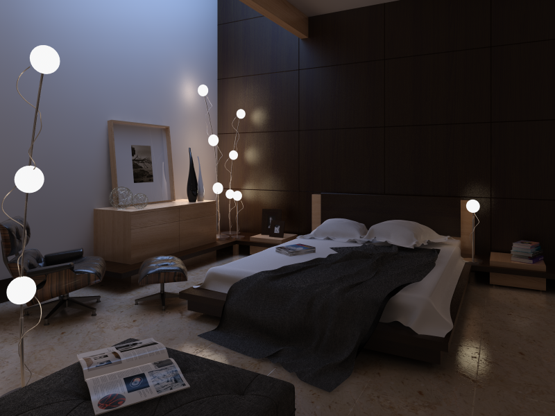

it would be nice if you could tell us something about the lightning. Have you used luminous geometry or LW lights?
I like that mood also very much! I realize a bluish ceiling light (not visible from that POV) that gives a bluish mood. The light bullets are reddish but are not the key light.
Thanks in advance
jfk
Thanks in advance
jfk

Light is basic:jfk wrote:Hi Johny_quick,
Thanks in advance
jfk
Physky 3/6 without Sun.
Lumi balls are with Raytracing Shader 800% Lumi yellow (this is only for reflection effect)
All lumi balls has Spherical Light 200mm with Inverse dist. 500 mm and Power 5, yellow colour.
Tonemaping: gamma 1.0/Exponential 3.5 , 40% blending.
Last time I see in Kray Tonemaping big possiblites and combinations, this is very good part in Kray (just need experiment)

As usual, very nice soft light, nice blur reflection, no splotches. Awesome!
You always have your fabrics flying above the floor

Hi Johny_quick,
thank you for your answer.
I think now the light is very beautiful balanced between cold and warm. I like it!
jfk
jfk
