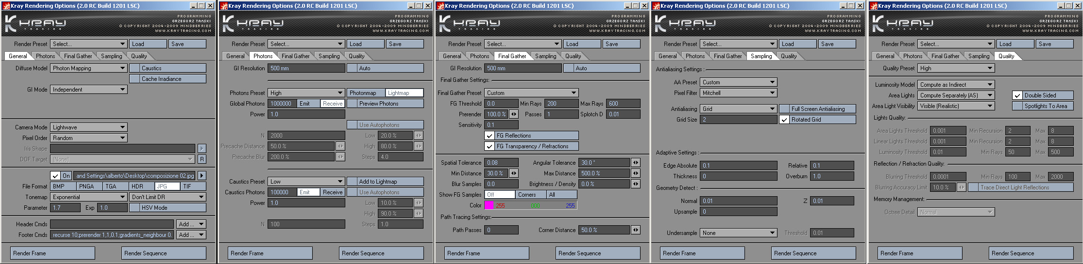

thank johny...
this is the image.. and this are my settings.. I don't know 20 minutes!.. is too much..
is very slow specially during antialiasing..
the lighting is made from luminous polys and ph-sky
thanks!..
thanks!..
