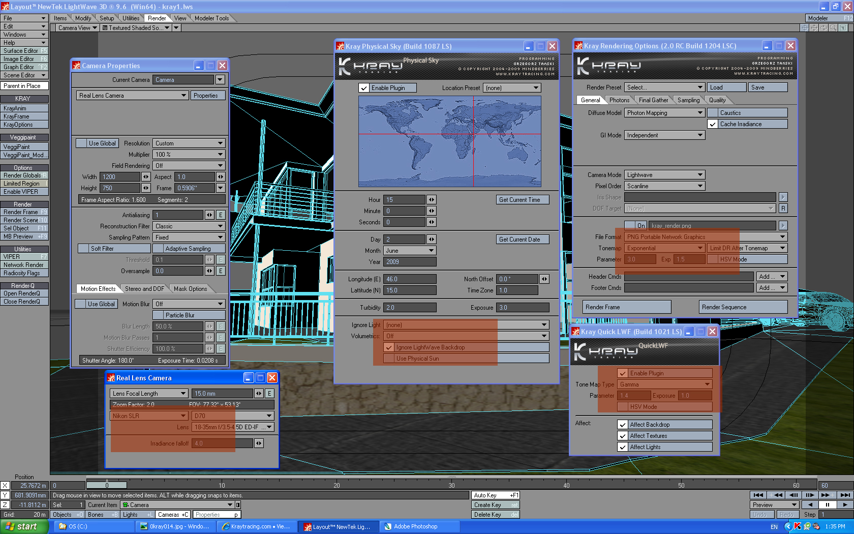

this was an old model, no nodes used. i think LW has no node surfacing when i did this model. i jsut load it and didnt change anything but just render with kray and see what it going to look like. trees n sky are PS. attached here is the setting i used in kray, i marked with red box to show only the changes i did. phy sky with sun off. "medium" preset setting. i use area light as my sun, with inverse sq.m, 1 km away. no tonemapping just kray QLWF. this settings may not work with others but doing a lot testing QLWF or tonemapping until i get that balance that makes me
