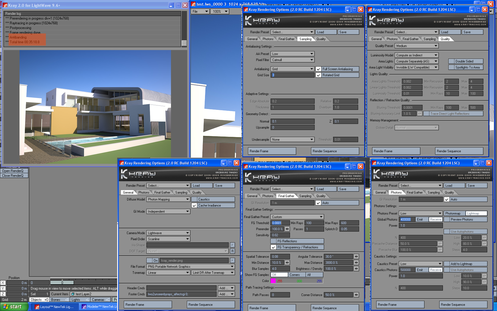

here is another one that frustrates me. im on texturing stage now and my test render is sooooooo slow for a test, please see image.
35 minute is too slow for me. i am guessing it's my reflective and transparent materials. before that i have not assign transparency and reflection yet and my test render is fast. any advice or tip about reflectivity and transparent materials? thanks

because of too much frustration i forgot to attached the image and settings. here you go
Re: help on fresnel effect on glass
For testrenders i think you have quite high settings.
Choose "General/render preset/Low for a start. Also turn off Antialiasing or atleast dont use fullscreen AA for tests.
Under finalgather tab, choose Minrays/maxrays 50/250.
What cpu are you using?

Can you show your transparent/reflective surface settings? the render time is indeed unusually slow. I use fresnel node for my glass surfaces and it works fast and looks fine... I can send preset tomorrow if you want.jdomingo wrote:here is another one that frustrates me. im on texturing stage now and my test render is sooooooo slow for a test, please see image.

here is my glass setting, purely from LW surface preset. please tell me if i am right on this. if i am doing a low setting on test render, i wont get same result when i increase to higher resolution for final render using low setting right? i am thinking since its a low resolution example 800x600 or 640x480 even with a kray high setting will render fast. only when i make high res render then it will render slow. i dont know if i confuse you, pleaes enlighten me. thanks to both of you
This preset is no good. Maybe it looks good in some scenarios but it has no fresnel properties and why the heck is translucency used? Glass has transparency, reflection and refrection properties which are linked together with Fresnel equation. When using Kray you would generally want to mimic this physical properties of materials to obtain most realistic results.jdomingo wrote:hi jure, thanks.
I'm attaching my basic window glass preset. Try it and tell me if it works better for you.
Yes that is true. The rendertime depends on the size of the final render and on the render settings. Use medium settings for start and change FG and AA settings for final/test renders.jdomingo wrote:please tell me if i am right on this. if i am doing a low setting on test render, i wont get same result when i increase to higher resolution for final render using low setting right? i am thinking since its a low resolution example 800x600 or 640x480 even with a kray high setting will render fast. only when i make high res render then it will render slow. i dont know if i confuse you, pleaes enlighten me. thanks to both of you
For test I suggest FG min rays 100 max 400, pass 1 - other settings leave at default. Sampling tab Grid 2-3 FSAA ...
For final I suggest FG min rays 100 max 800, pass 2 - other settings leave at default. Sampling tab Grid 5-6 FSAA ...

Hi Jdomingo,
Also turn off doublesided property of the glass. If you use Jures glass preset im pretty sure you see a speed improvement.
Tell us how it goes.
