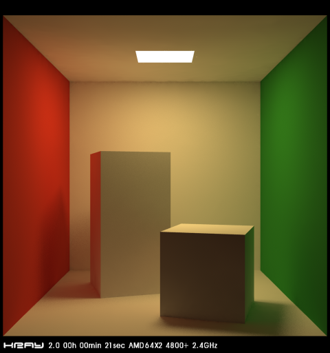

before was with LWF and Reinhard.
Now only gamma 2.2
light source as lumi panel + caustic.
						Now only gamma 2.2

apparently they made a simplified version of the simulation back then that we all came to be known as THE "Cornell Box" that is shown here:
I made my LightWave scene look like that to try it in Messiah:Render in 2001.
In my earlier post you see the result on my new AMD dualcore, the dualcore computer I (just) had 4 years ago.
I tried a load-and-render of the original 2006 LWS (also included in my attachment) and saw that the rendertime was about 15 secs now (!!!?). So kray has become much MUCH faster itself, even if you halve the original 1core kray 1.6 time because it now uses 2 cores unlike kray 1.6. The old settings do not give the exact same result (many code changes since then) so I did some changes to bring it to 2009 standards:
After that I rendered it on my present computer (Intel Q6600 3GHz quadcore):
I learned a lot about photonmapping back then with this box, like using precomputed modes of kray to check if you have enough photons, cell size and back then we could not blur the maps yet so it was much harder to find a good balance.
What strikes me most now, is that this scene does not use any QLWF and tonemap blending and it just looks right in bounce with just gamma 2.2 on the endresult. But there are no textures to mess up and the colors of the walls and lamp are reverse engineered by me based on the original. Please all have a go with PM instead of LM and using lumi quad instead of arealight and QLWF and tonemap blending with other surface and light settings to see what happens. Enjoy!

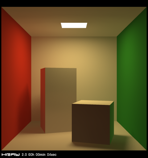

Re: Cornell box testing, how to speed it up?
He he "dot the i" 6 sec.
...and my 3 sec....
I won't be happy until you get it under 1 sec Johny!Johny_quick wrote:...and my 3 sec....
				erwin zwart
- Posts: 152
looks like crap.. , see contact shadows of low box, just render my scene on your 8 core and it should take also 3 sec and look good.Johny_quick wrote:...and my 3 sec....
I can make it faster but not without loosing accuracy.
OK i give You 1 sec more....erwin zwart wrote:looks like crap.. , see contact shadows of low box, just render my scene on your 8 core and it should take also 3 sec and look good.Johny_quick wrote:...and my 3 sec....

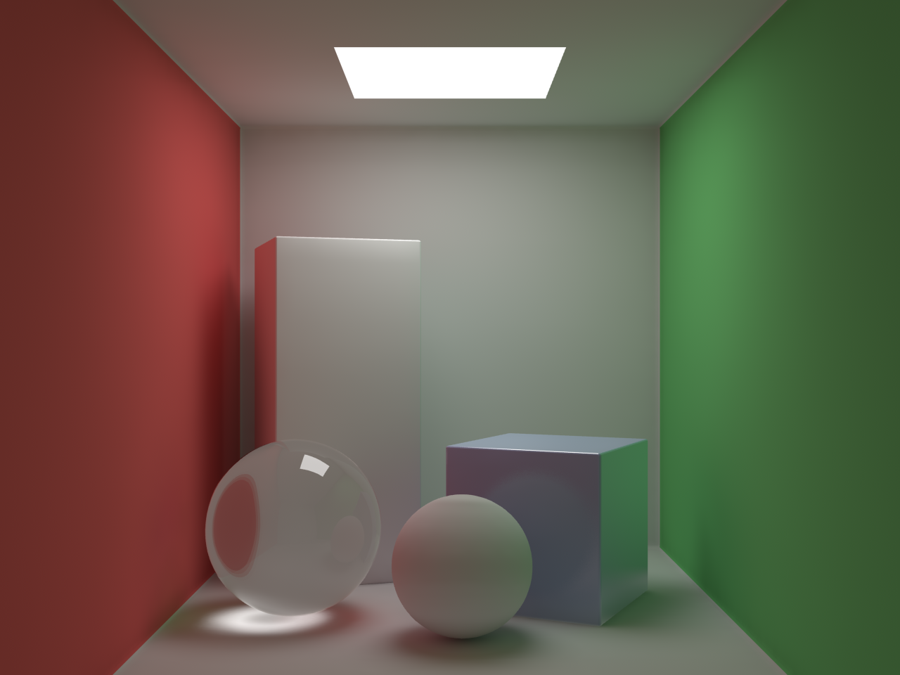

They are still floating though..
Got to check how Erwin did it in 6.. thanks for putting the scene up.
