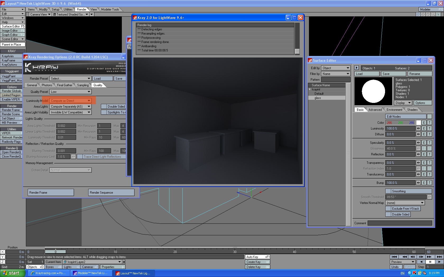

please compare the 2 images. this is really low setting only to show how to light up a room with only one small opening.
kray settings are:
1. physky
2. kray QLWF of 1.6 (it add that dark corner and contrast)
3. on the quality tab of Kray, change the "luminous model" to "compute as direct" (see image)
4. all kray setting are in LOW mode.
the luminous material is on another layer just incase you wanted it not shown
adjust the value according to your taste, as you can see from the sample image, the difference from 100 and 500 is obviuos.
play around until you are satisfied and once satisfied, you will be happy.
remember, all the images shown here at the gallery started from trial and error so dont be afraid to do a lot of testing.
hope this helps.
						kray settings are:
1. physky
hope this helps.
