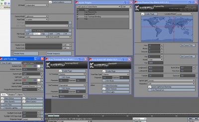

1/ try tonemaping Reinhard (gamma 1.8/exponential 2.2) in blend mode setup ~30% 0 this mean 70% for exponential, 30% for gamma)+ LWF gamma 1.8 Shader
2/ last time I looking good POWER from Kray but imho Power 1.0 is the best with recurse 15 (this is minimum and maximum )
3/ yes I see one problem with Area Ligts : SHADOWS , it is too strong effect, I wrote to G. mail asking to fix problem in KraySurfaceShader with Invisible Lumi Poly. better is put Lumi Poly wth behavior as Area light (fater render, soft shadows, etc) but now whan we hidea it we don`t see light.
4/ it is very IMPORTANT put extra light into windows (physky must be weak ~5 exposure)
5/ good idea is turn OFF physky SUN and add normal Spot with PowerShader (maximum 2 or 3) So fill light is from physky and extra light from widows.

I've always read that a good value for power was around 0.5.
One word about this change?
Re: Living Room
before we don`t have Reinhard blanding and LWF...but 0.5 is a bit too small, redners going to Raytracing view. IF You like 0.5 this is good but You must thing how raise colours in renders (power shader for light, LWF, reinhard) I trayed many things but I thing we must keep 0.7-1.0 Power in Kray. Key is in good tonempaing (need experiment with difference tonamepers in reinhard - this is possible in Kray)brownie wrote:I've always read that a good value for power was around 0.5.
Re: Living Room
I think, about power, that it depend from a series of variablesbrownie wrote:I've always read that a good value for power was around 0.5.
For example, you can use a value of 2, but in order to do that you have to decrease diffuse values on material... Or you can use 0.5, but increase Light Power using Photon Power Multiply Shader... It depend from a lot of factor and, according to my little and short experience, there are different ways ad settings (in scene settings) to obtain the same effect (or similar effect).
At the end, it is necessary to experiment in order to find a personal workflow. It is also important taking care of technical advises from people who know more (tone blending values, Lights and textures settings ecc.), but it also important to understand that are just good advises as far as they work well (imho, it is much more than possible that a good advise doesn't work for every scene)...
In other words, some technical advise are not a fixed rules (while some other are), but they work as far as you understand what are you doing...
