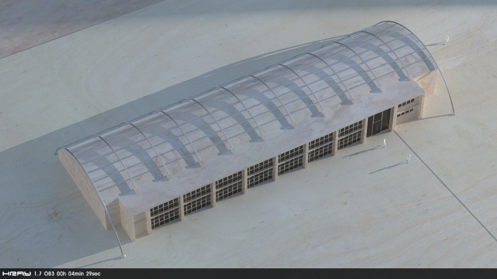

First OB3 Image
Post by florian »
Hi guys, I am just messing around with some old scenes, the new OB and sIBL (http://www.hdrlabs.com/sibl/index.html) which did crash with OB2 but works fine now.
Cheers, Florian

jure wrote:Nice Florian. Zoom in a bit more and use some DOF with new random FSAA.
Thanks. I saw that new FSAA mode. Any hints for some good starting point with the settings?
Florian

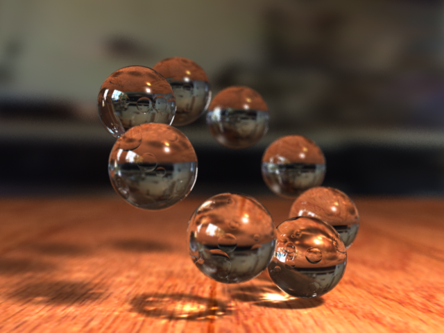

The more ray's the better! :D Use about 10-100 rays
Set focal depth in lw camera, open Kray GUI wich will now have "DOF target" enabled. Chose a null or a object to keep focus on ( i use lightwaves preview dof shift+F9 to estimate the dof but then you also need to set the focal point in lw). I will ask Grzegorz to add Zbufferoutput to all the other buffers so we also can do DOF in post.

Jut talked to G and he will add Zbuffer output tomorrow (already there but no output right now) He will try to fix both ,aliased and without.
Here is my simple DOF render 100 rays. With Zbuffer it takes as long as loading pshop.
