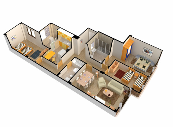

I'm having problems with memory too, y cant't render this scene over 1500 x 1097 ppi, wich is not enought for an A4 that I need for a client. tweaking any other settings doesn't seem to work, doesn't matter what I do,.. over 1500 x 1097 ppi will not be render also octree dept.. I put octree depht from 10 to 100 without succes,.. so i had to scale the image with genuine fractal pro for photoshop.
Problem with other similar scenes has not happent in large sice the limit was a bit higer about 3000 x 2193 ppi, bu the same problem happent at higer values,. and allways at the point of apliying filter.. after the whole render was done, I tried with pixel filter box, lanczlos and mitchell, but also without success.
Is there any other settings or reason that I have maibe missed, or some advice it may help?
Thanks

Does it has maybe something to do with the number of poligons in the scene..is there a direct relationship between number of poligons and the huge a scene can be render?. .. is just an idea
NiGMa
Posts: 129
Location: Australia
Post by NiGMa »
yes, it does have to do with number of polys, at least thats what I have found. I have rendered a 7000x3000 image with kray and about 4,000,000 polys(instanced, probably only 700,000 without the instances). But this only renders on my beast computer with 4GB ram running windowsxp 64bit. on my other machine with 2GB and only win32 it wont render at 7000wide, but it will at 3000. hope that helps =)
juli51_forum
Posts: 142
Location: Spain
Post by juli51_forum »
fine, thanks, so there must be some kind of memory limitation when rendering many many polys,...... is there other way to render such amounts of polys apart from lowering octree deept wich in somme cases doesnt seem to help,..or.. does it help allways? :)

i remember trying OCTree=1 for a scene on the smaller computer and it just wouldn't work, although I've been wanting to try the 3GB tweak for windows xp. I was watching the mem usage when I had OCTree=1 and it wasn't all used up, so that could be something to try.

Although the number of polys clearly has a major effect, I'm beginning to think the size and number of texture maps in use is also important.
I often use Poser figures to populate mid- to long-shots and even though they're not particularly poly-heavy, they do use a lot of texture maps. I find Kray falls over pretty quickly when the number of figures gets above ten or so.
If memory is becoming a problem, try resizing your tex. maps as small as you think you can get away with.
Phil
Currently the size of textures is the biggest headache for Kray. I found out that I wasn't able to render more than about 100MB of (uncompressed) textures with 2GB ram. The number of polygons is also a factor of course, but this can be controlled with Octree's to some degrees.
Unfortunately you'll just have to wait for upgrade which will fix many memory issues or you could go and buy more RAM. I have 3GB under winXP and it looks like it's enough for now (with /3GB switch).
