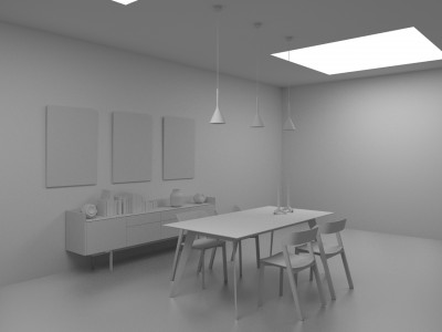

Now we'll do the same render, but turning of irradiance caching. As I said above, irradiance caching was "smart", by sampling the light at the most relevant points, and smoothing out inbetween. When you turn off irradiance caching, we call this mode QMC or quasi-Monte-Carlo: this is a "stupid" or "brute force" method: the lighting is calculated for each individual pixel! This is much more precise or exact, but it is a) slower and b) give noisy results instead of smooth results. The more rays you fire to define the light and shadow, the less noise, but the longer the render takes. (for the record, the QMC method gives you the best results if you have the time, with LW lights or with LEM polygons). You'll see that the contact shadows of the furniture legs and painting are very good, but a bit noisy.

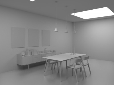

And lastly, let's hide the big LEM polygons and turn up the QMC quality. Hiding is done by going to object properties and unchecking "seen by camera" and "seen by rays" on the object - you need to put the LEM polys in a separate object. By the way, you can of course set different colours and strength of luminosity on different LEM polygons. Then you need to tell Kray that even though the LEMs are hidden, you still want to use them to light your scene, by going to Kray's "Misc" tab and checking "Unseen by rays casts light". In this render I've set the "Min Rays" and "Max Rays" on the Final Gather tab to 200 and 1200 to get less noise.
