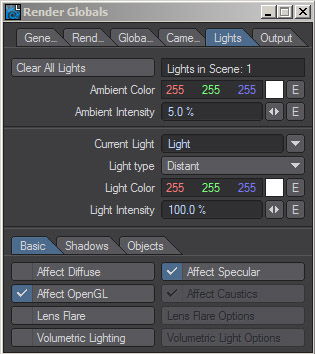

Our lighting artist ran into an issue with lights and kray. She want to add specular only to buildings - so "affect diffuse" in light properties OFF. (I know not to use specular, but we just use it on some shaders to give the last missing lighting on edges)

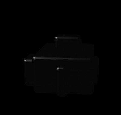

Gives her a nice specular effect in native lightwave render.

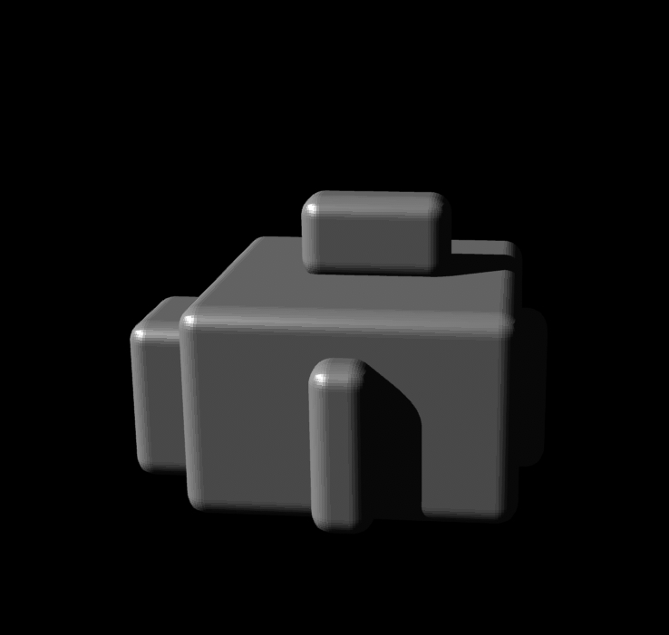

But with kray render it does not recognise the affect diffuse off setting and renders also lighted diffuse.
