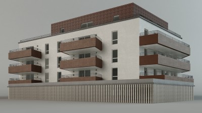

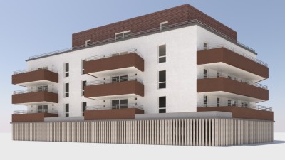

Hi!
What is the best way to render studio setup to exterior setup?
Studio setup
Studio setup
Exterior setup
Exterior setup

Thank for this question. Actually I needed something that for fast preview :wink:
Remember rescale object. Do not tweak Kray settings.
_____________________________________________
Studio_exterior.rar
(17.02 KiB) Downloaded 460 times

Thanks Janusz! I will try and post results.
Re: Studio to Exterior
Posted: Tue May 06, 2014 6:52 pm
by Alek6
Thank again, best result in textures.
