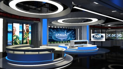

				by filmdesigner
-  Same scene in LIGHTWAVE
