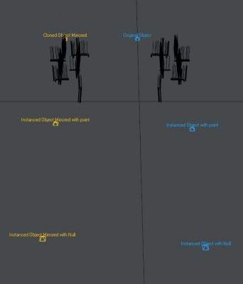

I did a simple scene with original object on one side and mirrored clone on the other side (-1 X)
Then I replaced both with Point poly + Kray instance
I did the same with Null
scene
scene

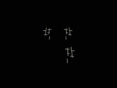

After render, it looks like this
render
render
Instance works on point poly but not on the one that has been mirrored.
If I parent them to a null and mirror it , same result.
So it appears Kray wont instance objects of child objects that have negative size values.
Is there a workaround to mave mirrored instances?

I checked the scene. It seems that negative scale is not working on -X but on -Y and -Z it is working. Looks like a bug.
